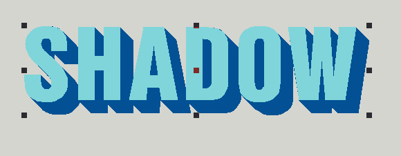

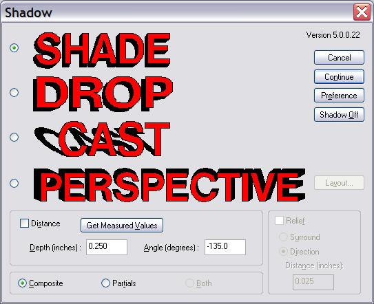

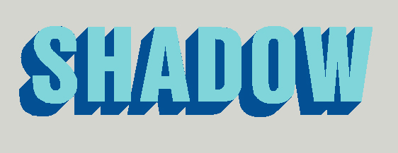

I am lettering a truck trying to match the other door. The shadow is going to the bottom left. But my shadow is going to the bottom right, how do I make the shadow go the other way? THANKS
  • Double click the shadow and click on the shadow effect to enter the Smart Edit dialog.
  • Add an appropriate amount (in my example it is 90*° to change from -135° to -45°) from the amount shown in the Angle box.

it's under the Gerber section so one can assume it is Gerber...
Fred posted the a really good "how to" and that's about all there is to it, good luck
