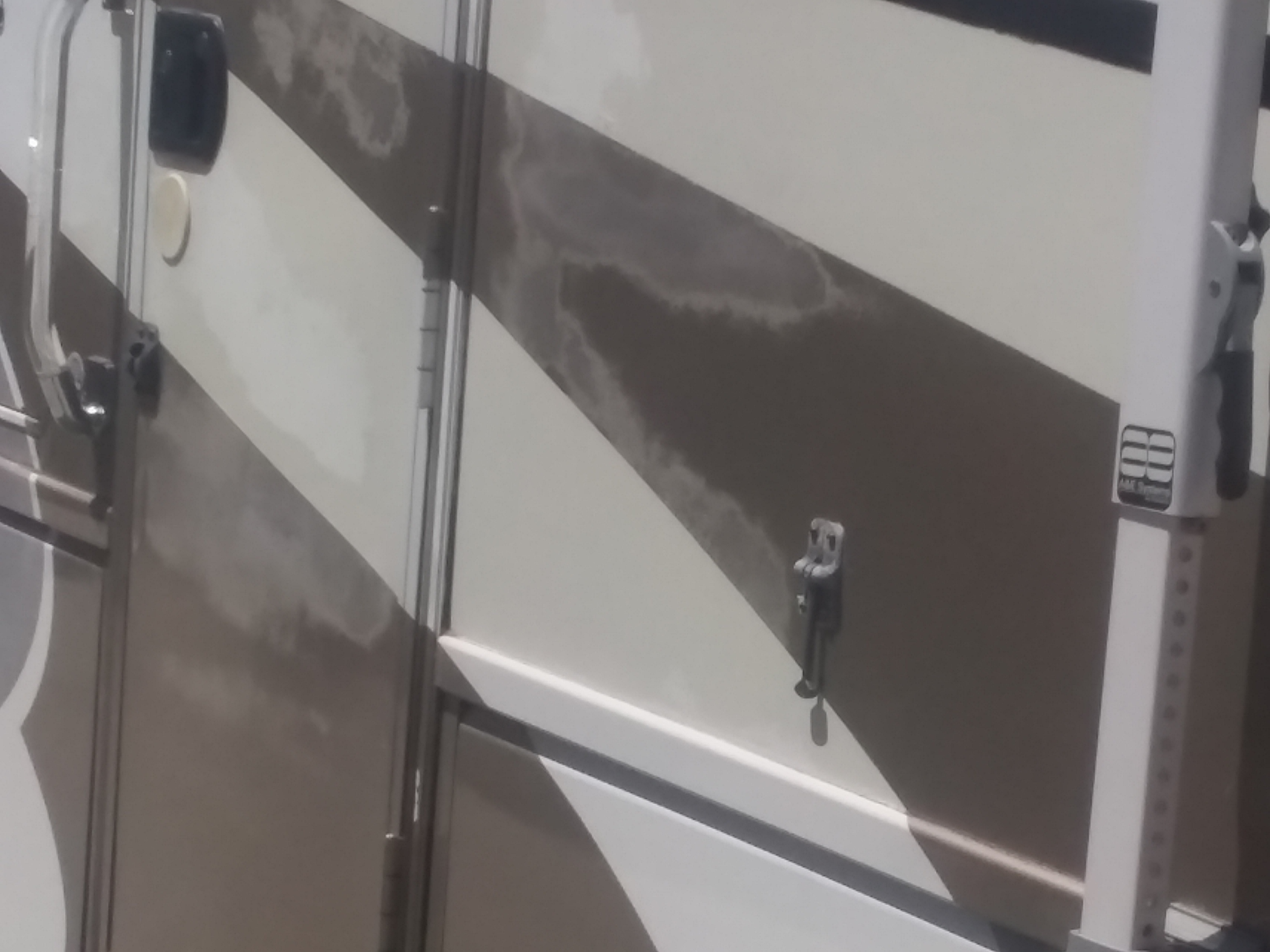

I got a potential client that needs some graphics on their Fiberglass RV.
Problem is, there's clear coat on the whole thing. Some places it is scaling bad.
Is it a monster pain getting it off? :confused:
If so, I'll turn away. :oops:
I forgot to mention:
There's No paint on surface. Just white fiberglass. It cannot be sanded without leaving weird uneven surface looks.

We've had customers sand the area clean, bring it back to us to apply the graphics then clear coat over it. As long as the boat was just white.

Unpainted fiberglass still has a clear gel coat, which has failed. So the solution is to either have the whole thing redone or painted. Either way it's not cheap.

You sure its clear coat? It would only have clear if its full body paint or has been re-painted over the gelcoat. Gelcoat is sprayed into the mold and glass is layed up over it. The finishest part comes out of the mold as a finished surface, they dont clear it.
I think someone did clear coat it.
This isn't my forte.
