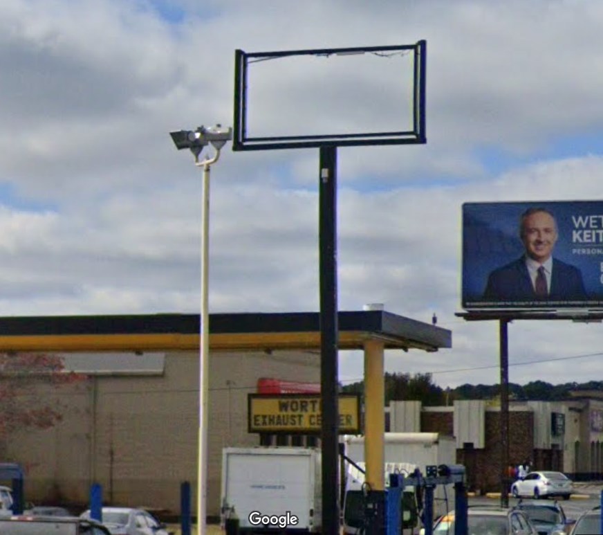

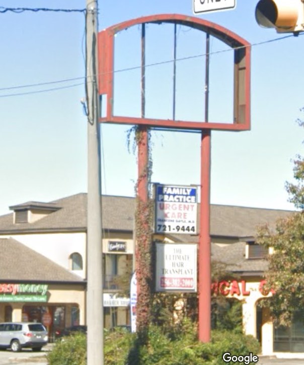

How do you remove Pylon or Post Signs that have become abandoned?
I am not a sign store owner nor do I intend to ever make a sign. I find describing what I need and purchasing them from one of you to be much easier.
I have moved to north Alabama, and I did not see much of this in the metro Atlanta area, but there are a plethora of post signs to commercial properties where the latest tenant was unable to
use the old sign and found another way to advertise their business. Apparently, there is no existing code to remove signs along roadways that become an eyesore over the years - I'm talking
about signs where the owner of the property probably doesn't want to pay for removal, and perhaps the municipality's hands are tied because it is private property.
I imagine people familiar with this forum would know how these types of signs are dealt with in areas that routinely take out abandoned signs - I don't tend to see them as much in larger metropolitan cities as I do smaller cities.
I have attached a couple of local pics, I know one is being used for other types of signage, but I could have posted dozens that fit my description from the area.
Thank you for reading!

Commercial Realtor AL are you asking how these signs are removed in the practical sense of how it's physically done, or are you asking how to force a removal thru some sort of enforcement action?
If it's the latter, typically sign codes are enforced by complaint, so you need to find out how to lodge a complaint with the city's code enforcement people.
Our local city will allow signs to stay up as long as it has some sort of face panel in it, even if it's just blank white. If the sign was originally installed under a permit, you can change the faces in it. They call those signs "legal nonconforming". However, as soon as the structure is altered, they have to come into compliance.
If you are asking how it's done physically, it depends on the situation. The quick and dirty way would be to torch the pipes off at grade level and weld a cap on them. When we used to remove freestanding signs at car dealerships, they wanted the pole and footing demo'd out at least 6" below grade, cap the pole, and backfill/patch over the area to bring it back up to grade. That was because the car manufacturers actually owned the dealer signs and the dealers paid to lease them from the manufacturer. The manufacturers didn't want the dealer to be able to reuse the sign footing for their own purposes.
The most difficult removal method would be pulling the entire footing out of the ground but then you've gotta back fill that entire hole. Plus hauling off and disposing a chunk of concrete like that can be difficult.

Like others have said, the easiest, most cost-effective thing to do is cut the poles off as close to grade as possible and cap them. It's a lot more trouble to remove the entire pylon and concrete foundation in the ground. Such things are rarely ever done.

No, thank you all for your thoughtful and imaginative answers. I have been reading them, and just didn't know how to respond as they tended to roam in different areas.
1) My interest had been, since I did not see any of these signs coming down, the expense of investing in the tools necessary to remove such signs - I just did not know what the preferred methodology for removing such signs would be. Multiple individuals (Texas Signmaker, J Burton, Bobby H) gave me the answer on how to technically remove the sign -
to dig well below the sign, cut at approximately 12" below the surface, and cap the (stub is the term I'll use) remainder in the ground.
2) I have yet to investigate, but there is a chance that whatever code is out there is not being enforced because no one is bytching about it - not that I have ever been an activist in any area, and don't intend to become one. I had thought, since there was so many of them, the expense was enough for someone to specialize in doing nothing but removal of such signs if the city fathers were in the same mood of "beautification" by subtraction. From what I see by the responses, there are plenty of people who know how to do the work and can, the issue is apparently (1) is there a code with teeth in it and (2) who pays for elimination of a sign when the building is not at a state of demolition?
3) I believe that I have received the answer to my unspoken query; is there an opportunity to open a business that would focus on the removal of such signage? The answer is, there is very little profit available (because perhaps there really is no entity that wants to pay for this) and the equipment required is very expensive. So, even though it looks like an opportunity, the hassles of getting new work and the expense of the required equipment outweighs the provided benefit of beautification by elimination.
