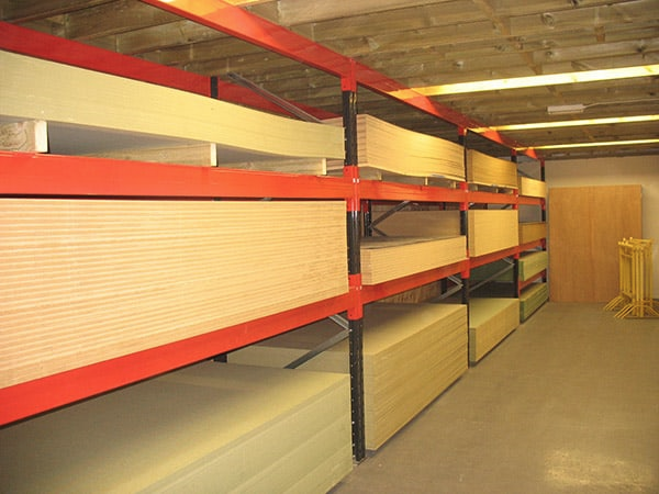

Pretty usual type of setup. Maybe not so heavy duty as you lose quite a bit of space as height to the beams.
Plywood on the bottom.

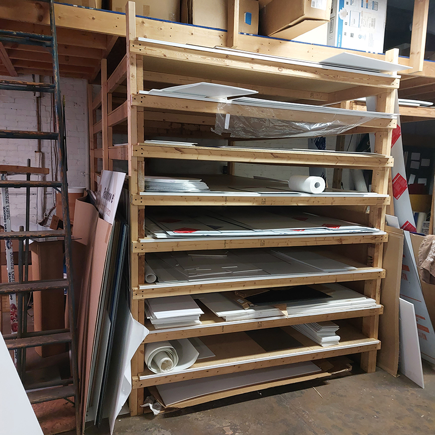

For flatbed substrates, we built a shelf system 6' x 10' with about 10" or 12" in between. There's a buncha cutoffs in it at the moment, but generally the 60" stuff is at the top.

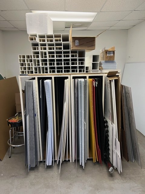

I had this metal rack welded up for me about 15yrs ago all out of 1in x 1in Square Steel Tubing.
It holds alot of 4ft x 8ft Aluminum, PVC, Coro Etc sheets and doesn't take up much space. Real easy to slide panels in & out since the sheets are vertical.

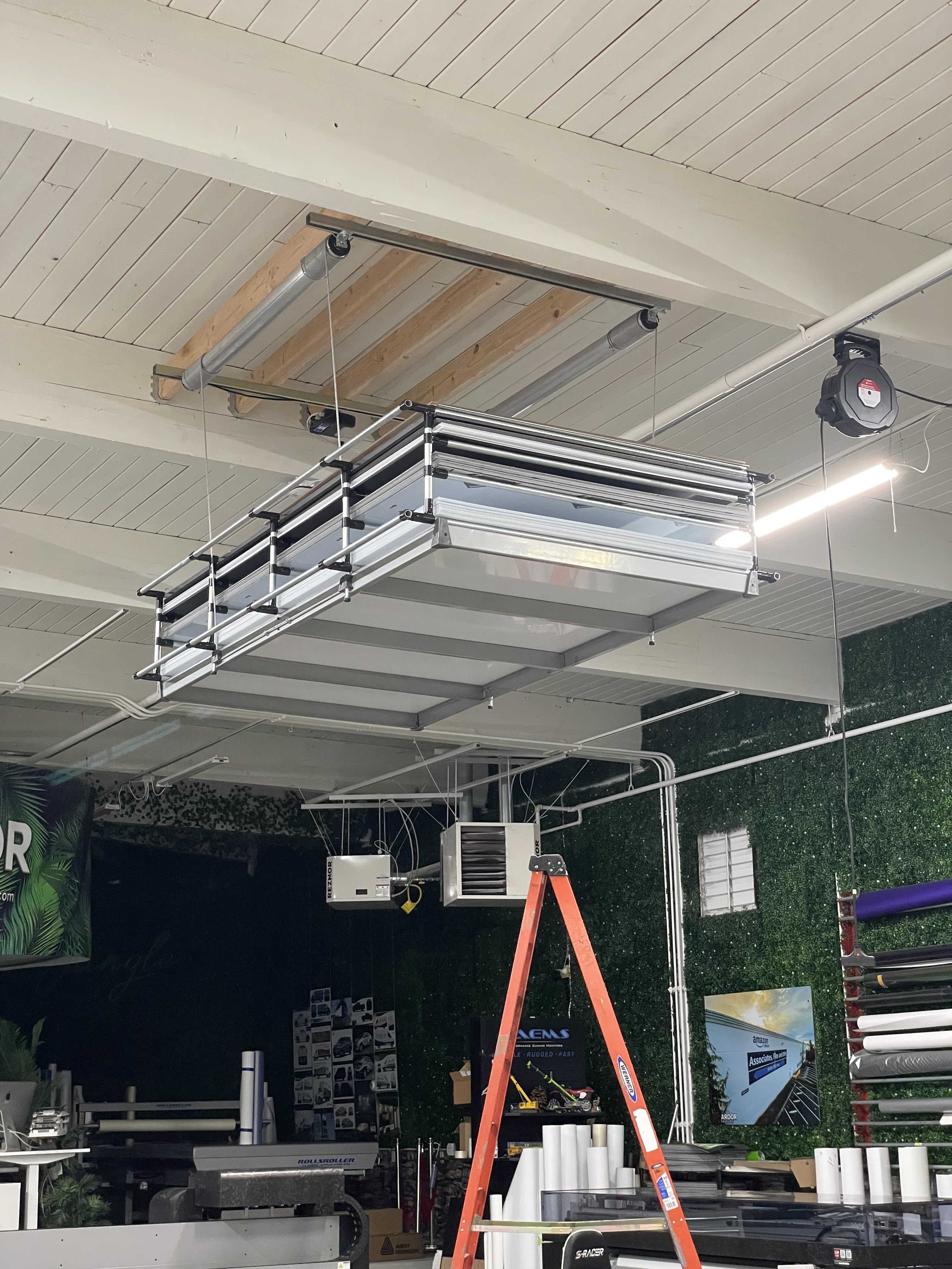

Just recently installed an overhead storage rack that raises to the ceiling when we don’t need it. When we need sheet stock it uses a remote and drops to the floor. I installed it right behind out flatbed printer so sheets can be dragged right from the rack onto the table and then sent back to the ceiling or kept there for continuous feeding. This one was test and it went well, I plan on installing 5-6 more in the near future and free up all available floor space. I highly recommend something like this.

I like this idea, but I would be constantly worried it would fall and kill someone.

We also have ours in a short edge vertical configuration.
In addition, we put oversized caster wheels to move as needed

Very impressive. The wheels are turning now, wish I never saw it haha

God I love the idea of a suspended pallet, but I'd think to load it with 5x10x.090 sheets, and that doesn't make me want to walk under it. I'm curious, has you insurance company spotted it yet? They tend to have hangups about suspended loads. May want to at least make a yellow line under the area, just to point out and say 'of course nobody walks there....'
That’s actually not a bad idea, I will make a nice reflective floor decal marking the area to stay clear. Thanks for the input! As far as aluminum sheets, I probably wouldn’t use that specific rack for something that heavy. I believe it’s rated for 600lbs, I know it would lift more but I’m not really interested in pushing it. We mainly store ACM, sintra, corex, etc up there. We have 3 more smaller ones that are only rated for about 120lbs. We use those for all of our anti-fatigue floor mats. They aren’t really heavy but they take up quite a bit of room. We currently don’t use much aluminum, we are mainly a printing company,but soon will be purchasing a couple large lasers and will need to come up with a solution for aluminum sheets. When the time comes I’ll likely hire someone to build a beefy version of that rack that can handle a lot of weight. Once you start storing stuff on the ceiling it’s hard to go back to the floor lol.

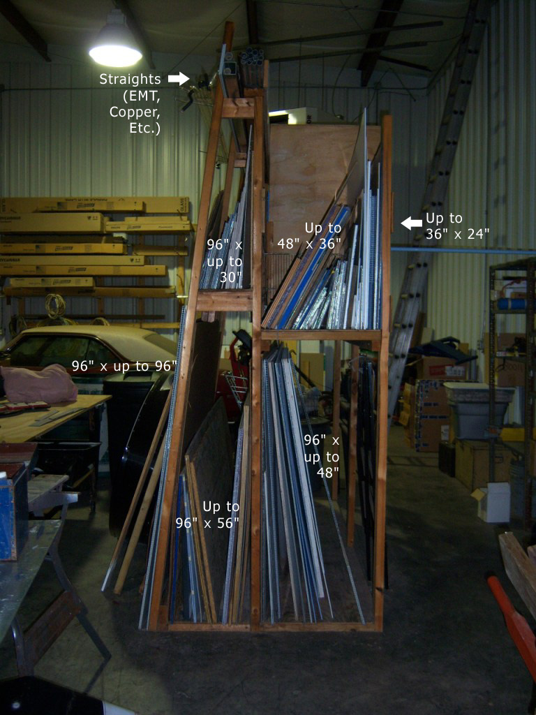

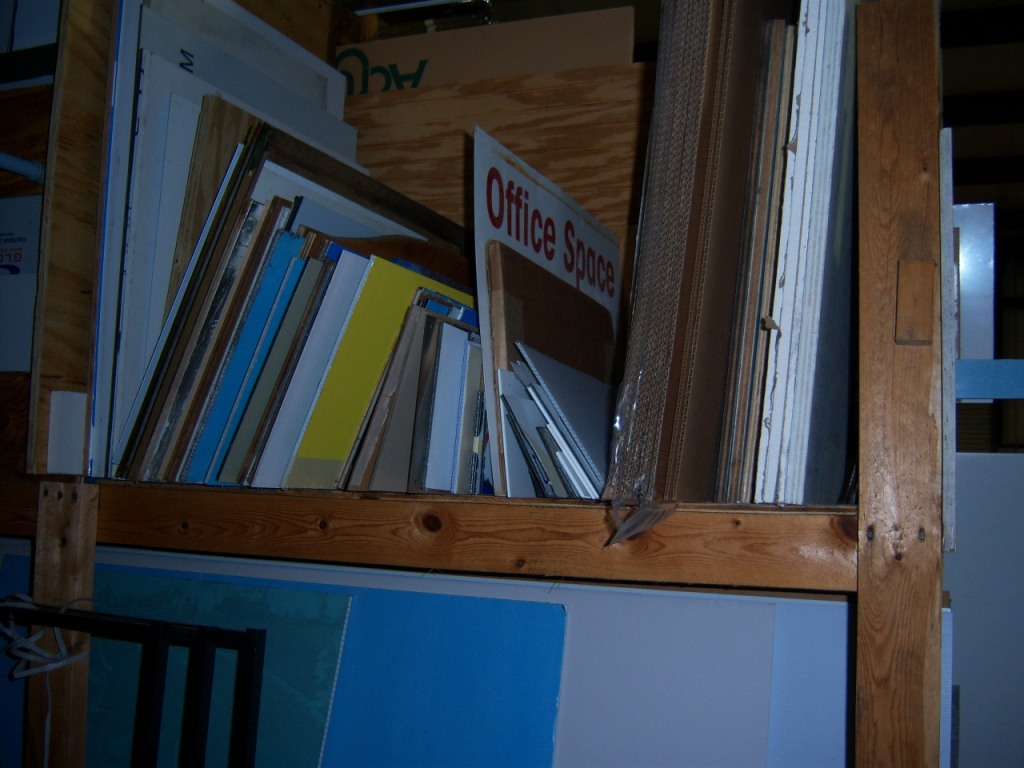

The first shop I ever worked in had been an old sign & glass company. Naturally everything was stored vertical, except for the thousands of old pounce patterns. They were above the layout tables in a chicken wire cage.. Sorry these are the best pics have of this rack. The rack only has a 4'x8' footprint and was 9' tall. Because it wasn't against the wall, it would hold 10' pieces and even 12' in a pinch. Maybe not great for a high volume shop, but I've always been a custom, one off shop and the design served me well for years.
Like Gino says, the drops are gravy. I saved everything. Need a test piece for paint? Got it. Need a 3/4" match-plate to set J bolts? Got it. Need an 8" x 96" piece of ACM, without using a whole sheet? Got it. Need a chunk of OSB to lay across a ditch to get the wheelbarrow in? Got it. I went through a fire and the soot ruined most everything in the rack. I remember taking it to the landfill and every time I chucked a piece, I was like there goes 10 dollars, there goes 15 dollars. and another 20 dollars.
