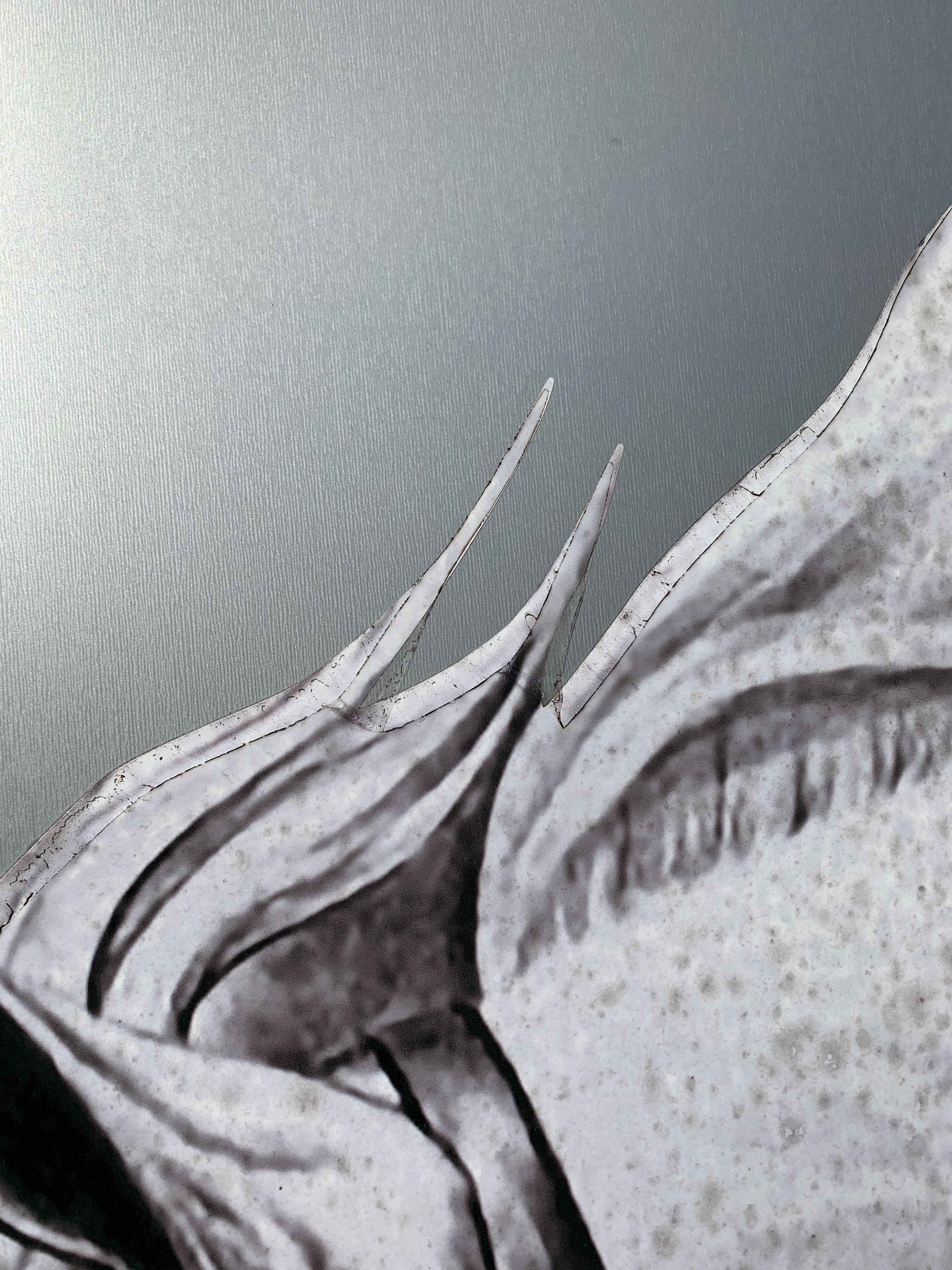

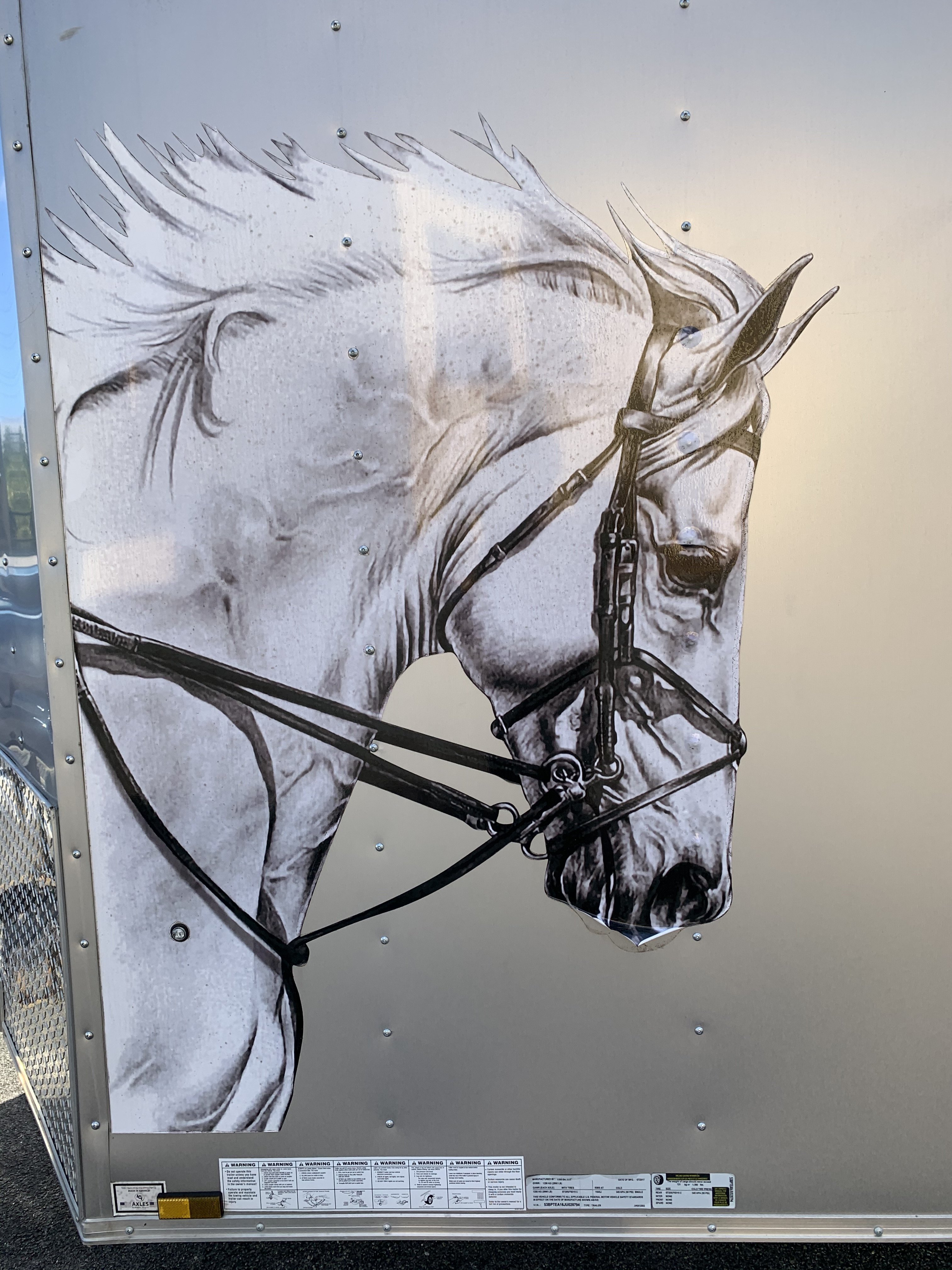

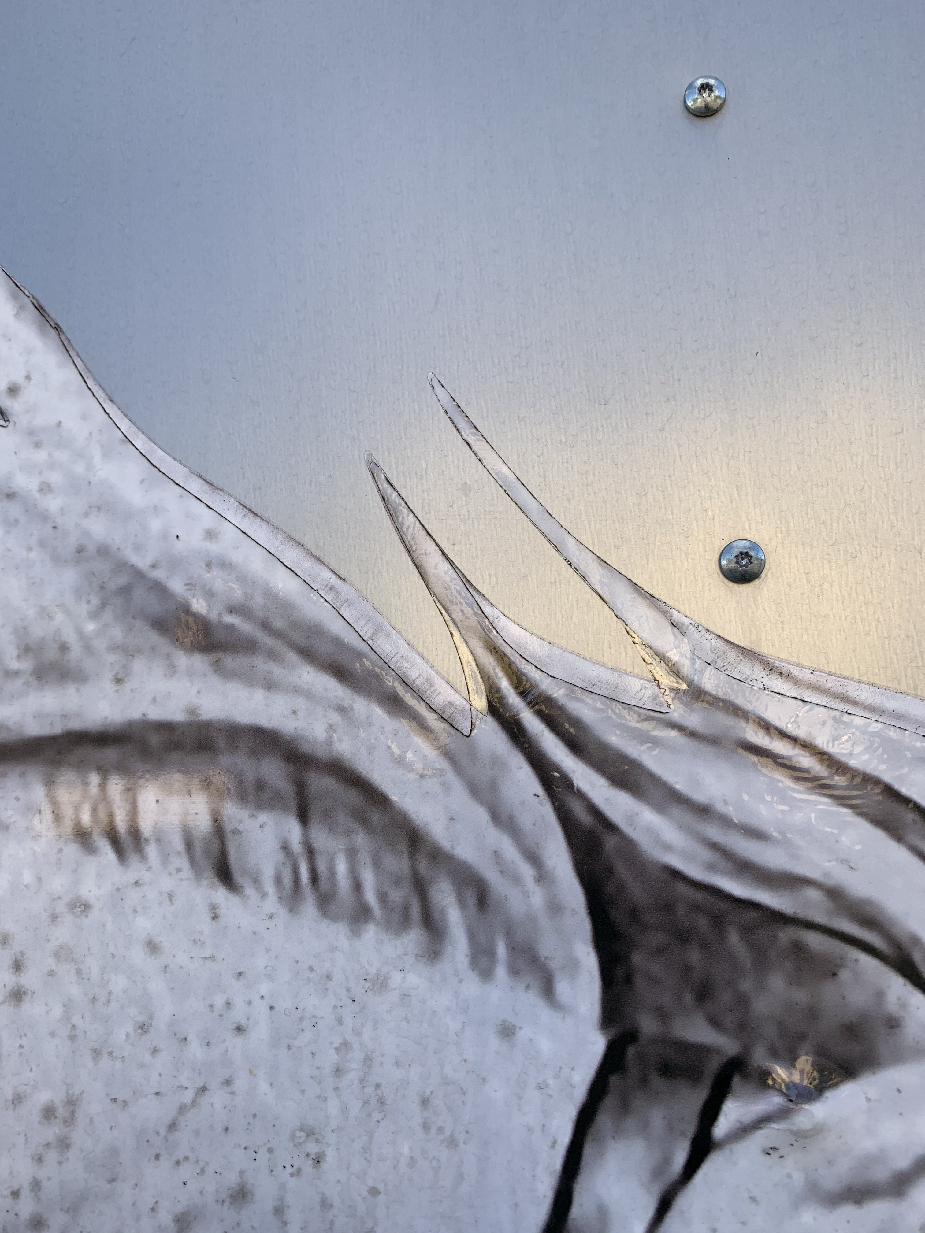

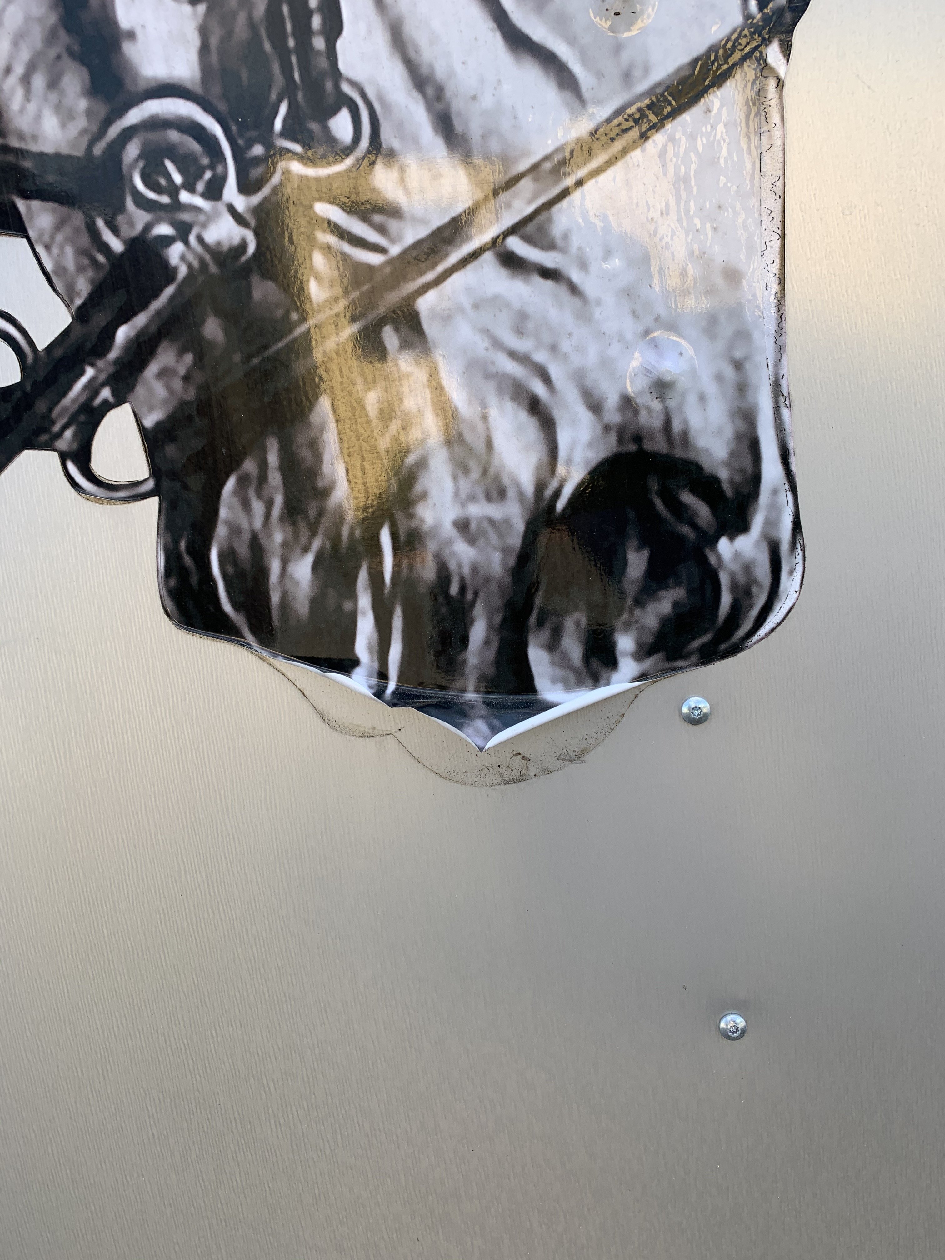

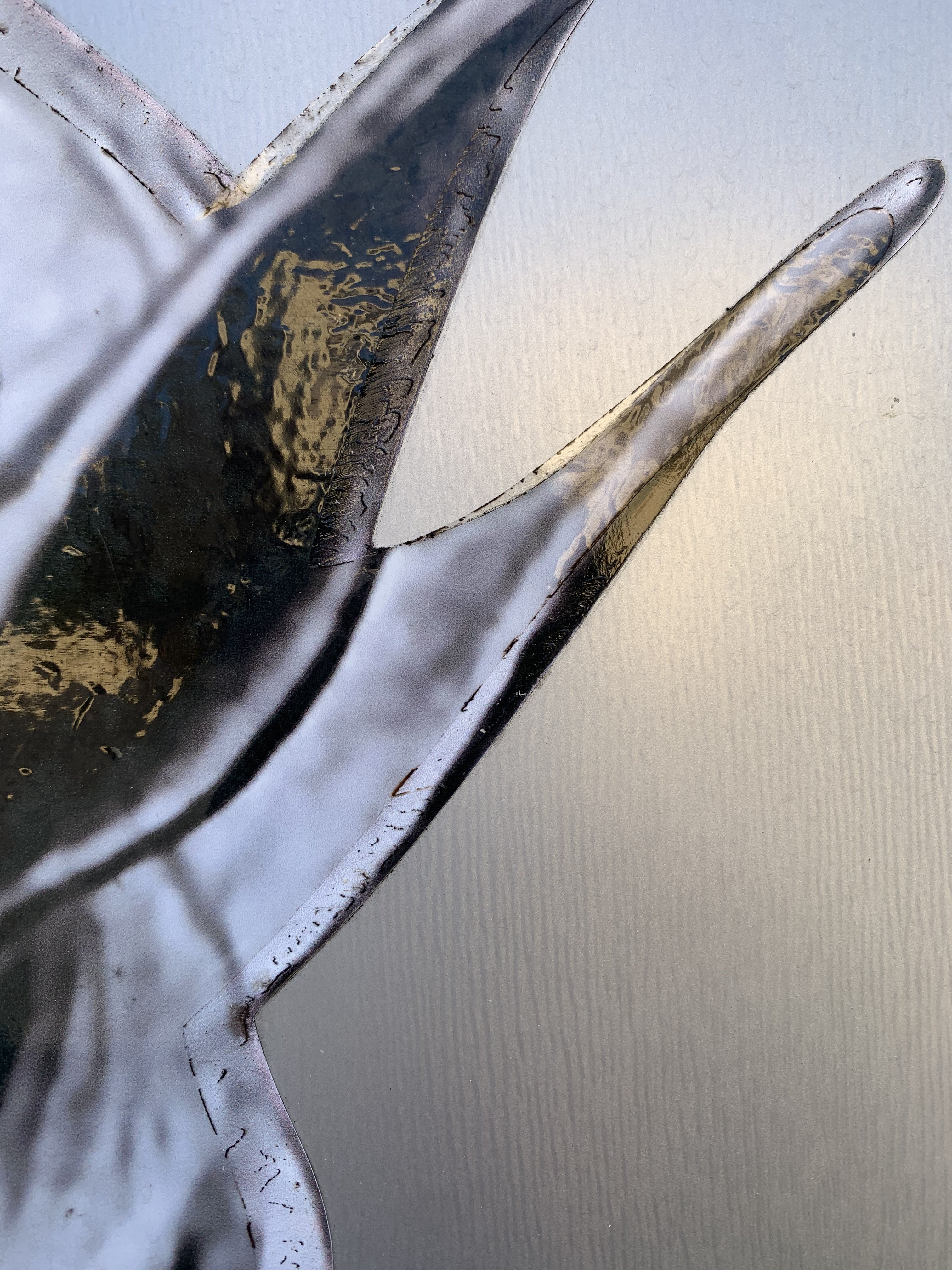

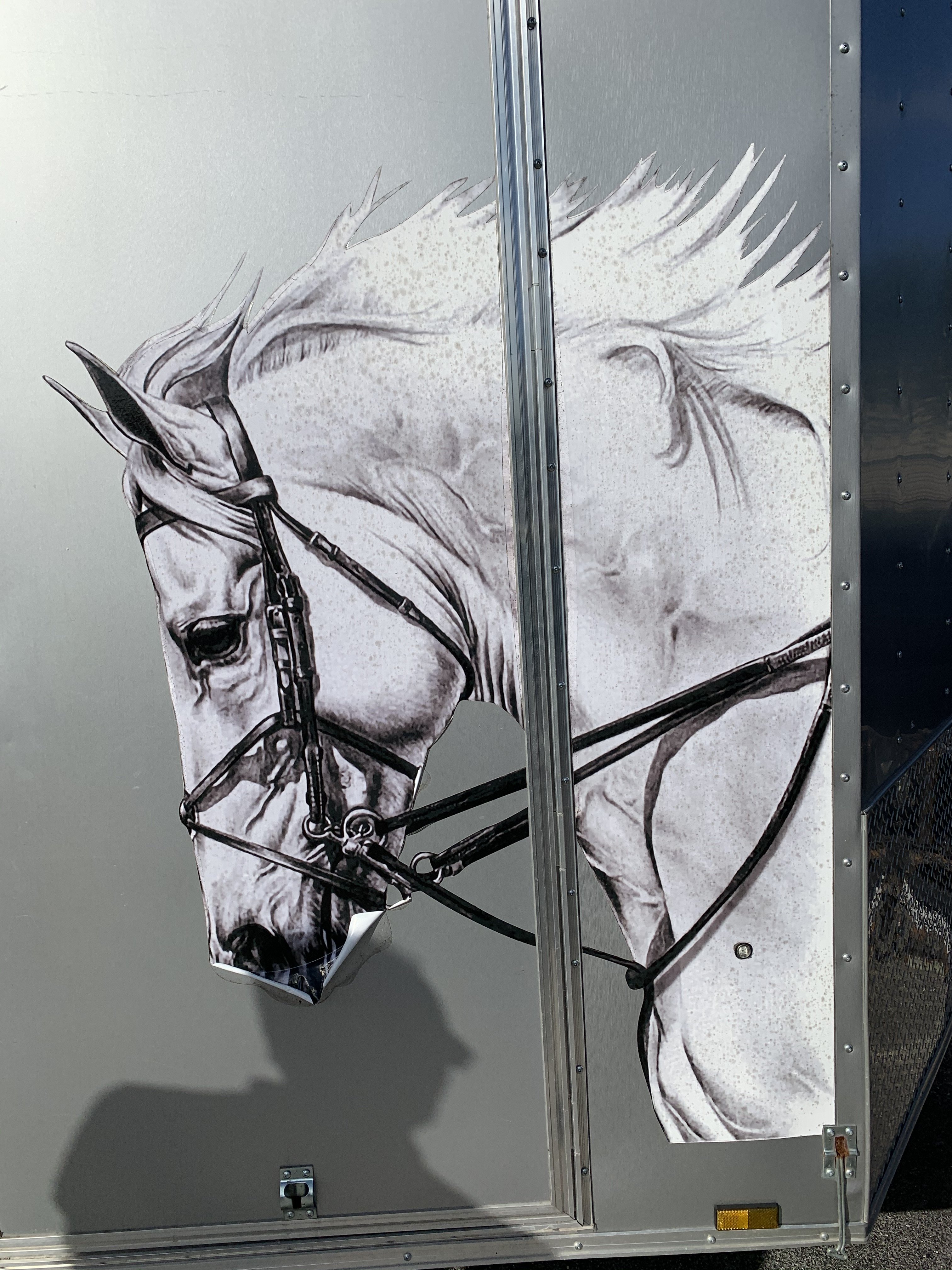

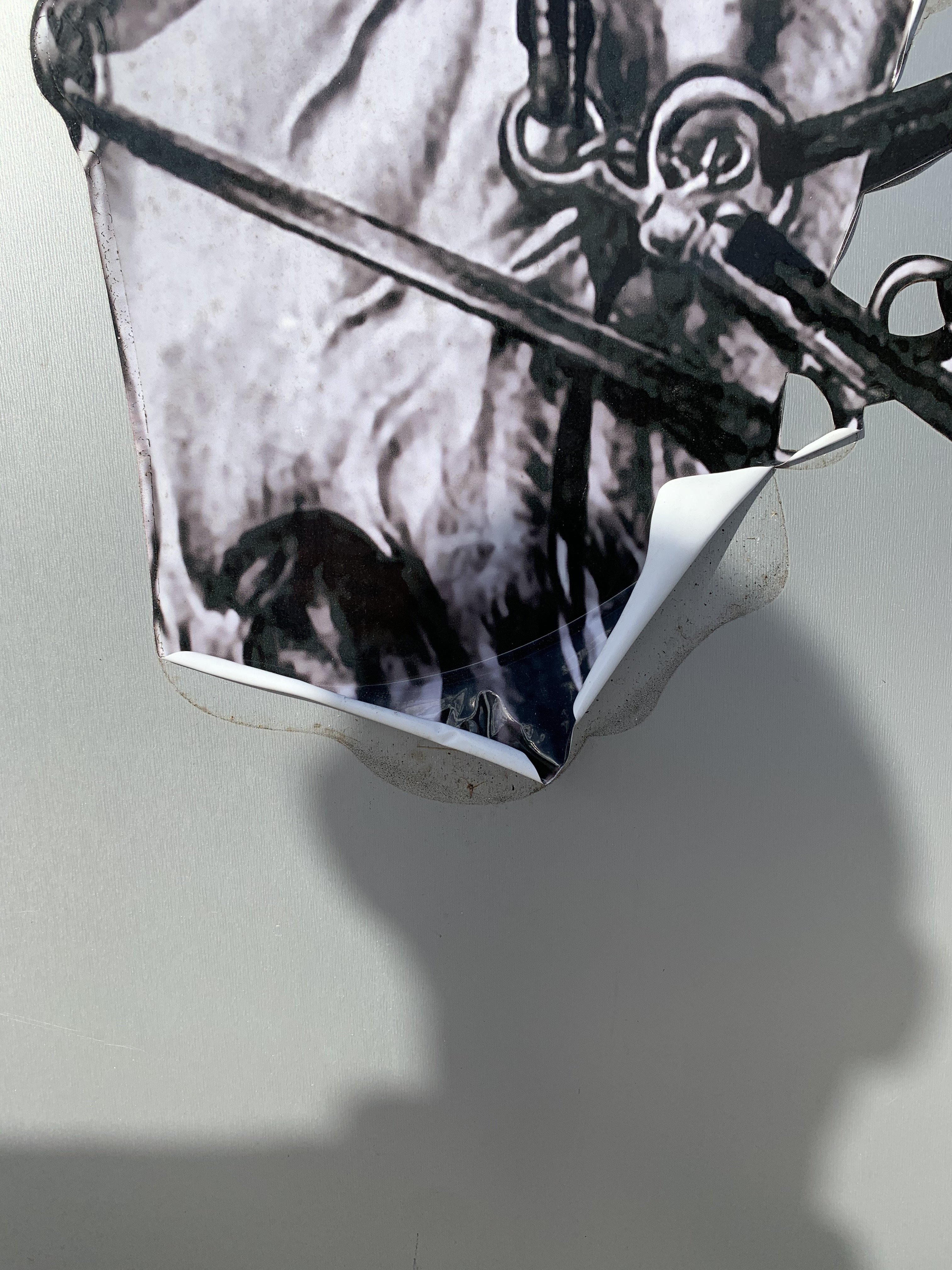

The other day one of our customers brought his trailer by to show us that the graphics that had been installed in late 2018 were now peeling up. I think he probably did this with Oracal 3640 and 210 Laminate - which explains why it's peeling up at this point. I've checked through all the email correspondence I can find and can't find any place where they might have explained how long it should last, but based on the customer's expectations it seems he expected longer than a couple of years.

From the photos, it looks like he used the wrong lamination for the vinyl. May have used a 2 year vinyl. In any event, the question here is really about how you define your business and what reputation you want for it. Personally, I would redo the horses - no charge. The customer will remember that you stood behind the work and made it right. They will also remember if you put the expense on them. I have been in a situation many times in my life where a company tried to avoid standing behind their work and wanted to charge me additional to repair - guess how I felt about that and how much more business they got from me... I would explain that you just took over the business, and tell them you want it to be right for them and that the work of Signs Welly(?) is your best form of advertising. As too the materials to use, I would suggest leaning toward vinyls with longer lifespans paired with the proper laminates. We use Arlon SLX Cast Wrap with Arlon 3270 and/or Oracal 3951RA paired with Oracal 290 for signs like that. 26 years in business and we have a reputation for quality and customer service in our community. Hope this point of view is helpful.

It looks like possibly cast vinyl with calandered laminate, notice the wildly shrunk laminate in some of the photos and the vinyl stayed in place.

Yes 100%, it's petty BS to bicker over $100. Those horses could not have cost more than that. For everyone saying the guy might have only paid for calendared vinyl, a good cal vinyl should last more than 2 years too. It failed on a flat surface, not over rivets or somewhere that it should not have been used.
