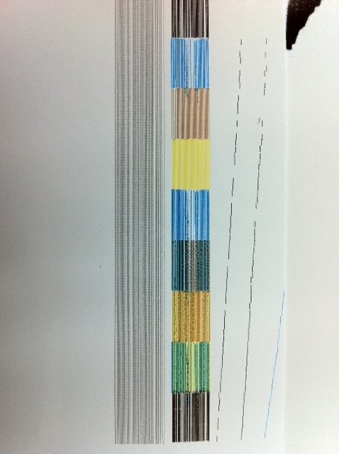

here is a photo of my nozzle check.....
whgjettdesigns
By the look of the nozzle check would you say that is what is wrong? And if so how often should I do this? And also is it going to be hard to get my heads back in the right place? Thanks for all the help!!!!
heyskull
I personally think it would be a mircale if you can bring that back to anywhere near acceptable.
How did it get this bad?!
Time for a new head and capping/cleaning station in my opinion.
