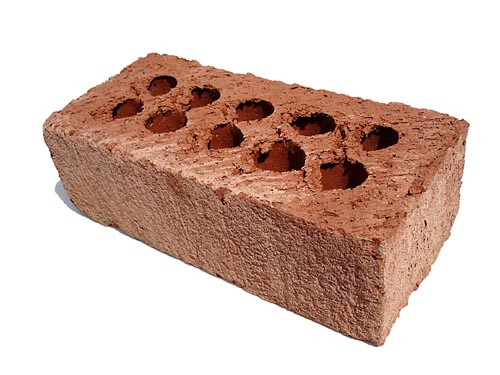

Most bricks are NOT smooth (see photo), and many have holes in them, I like the idea of getting one large piece of form, I live near a lake and we have a company that molds large 4' x 4' x 8' blocks and will cit them to any custom size with a hot wire. Find a source, have them cut a block to your specifications.
It would be easy to cut large holes in the foam block, and distress all surfaces and the edges and corners for a realistic look.
Cover the giant block of foam with Dryvit base coat and mesh, then when that dries, cover with Dryvit color coat using the fine texture, and when it dries, you will have a giant REAL looking brick that will hold up to any weather, and still be light enough to be portable if needed. One of the good points when using Dryvit, is the color is built into the finish coat, and hold up very good to wear, if chipped or scraped the color is still there, and future touch-up if needed is very easy.

This is true, here in Texas most brick has holes in it, so I was thinking you could easily cut holes in a foam block and be done with it, no need to build up a frame and then cover it. But maybe you could use card board tubes in a built up frame to make the holes?
