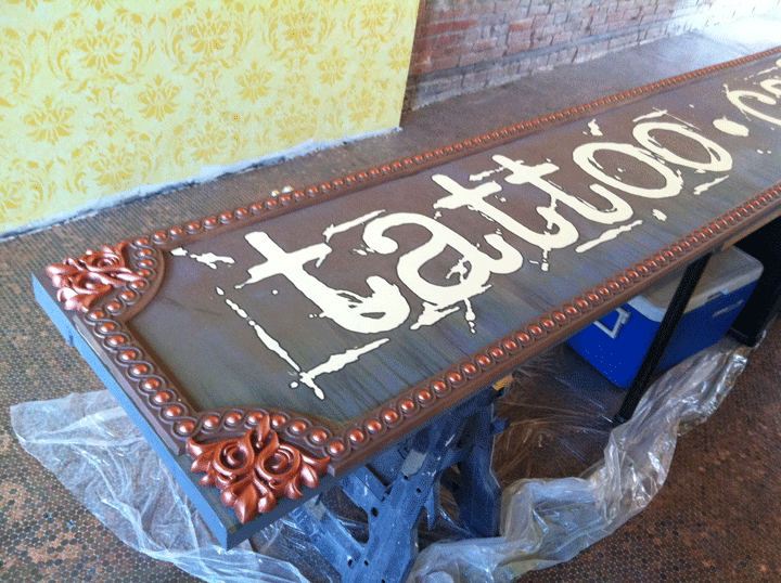

Hello all,
I am currently fabricating a large scale sign for a business front, which is constructed from 3/4" MDO. I sealed the edges with glue, and gave it several coats of outdoor latex for the base color. I have hand lettered the logos with the same paints. Now, from reading quite a few of the posts (and from previous unfortunate experience) I have gathered that using a clear to "seal" is not the best choice.I know definitely, not a poly that will crack and yellow. But what durable, long lasting option is there? What are your recommendations? Leave it alone?
Looking forward to your input.

Coat of liquid car wax and tell the customer if they want it to look good to wash & wax few times a year

Hello Bill, I am formerly a New Haven-er (small world)! I like the idea of waxing it, since it would give the surface a semi-gloss look. But would that "haze"?
As for the "lettering", I meant the text/words on the sign which is more of logo replication/artwork as opposed to hand lettering in a one shot, sign painter method. Sorry for the confusion. :)
Attached is an image of a portion of the sign to get a better idea.

Very nice sign, but that doesn't look like it will weather very well. Isn't that indoor wood trim for the decorative edges ??
Jillbeans
That looks like it might benefit from some sort of clear.
1-Shot makes an acrylic UV clear (white can with green and black lettering) you have to work quickly with it because it gets stringy. You can get it from Pioneer or Glantz.

I have had clients wax their signs and never had an issue with hazing.
I also have lettered with latex a few times, just took a little doing. I didn't even have lettering brushes for a few of the jobs, used "artists" brushes.

I was also recommended this product by a local firm that installs murals that are standing tough against the crap weather of Pittsburgh. Opinions?
http://buyat.ppg.com/rep_pafpainttools_files/Pghpaints/TDB/75-45.PDF
I am hesitant to use the 1-shot, since I have heard a lot of negative opinions about the current quality of their products. Truth?
The moulding is outdoor moulded HDU, that obviously is primed and painted and securely fastened on.

Gino ... like others have said ... it is not as easy as using 1Shot.
I use Langnikle Nocturna brushes and it takes at least 2 coats to get proper coverage.
Latex lasts much better that 1Shot.
