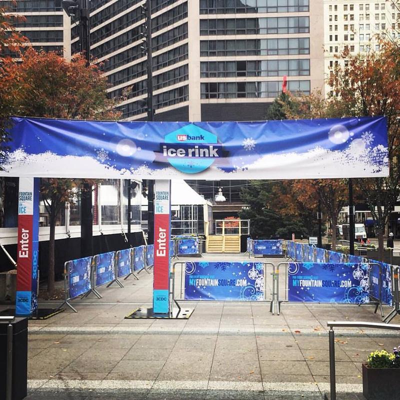

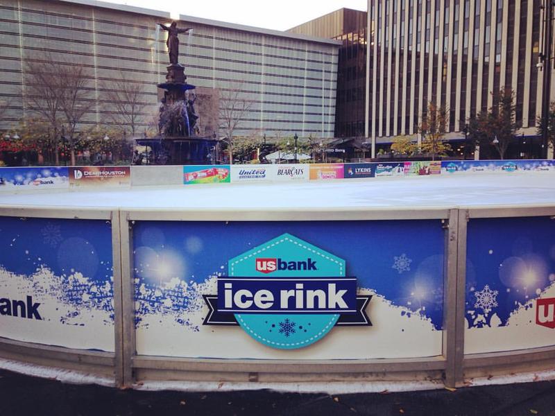

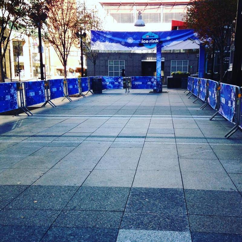

ANY type of mesh should work fine for under-ice graphics. We just finished the local rink here - WHEW! That is the biggest P.I.T.A. project we have all year; over 400 different printed pieces in one project... and EVERY piece of art came in at the wrong size, w/o bleeds, etc, etc. FUN TIMES!
