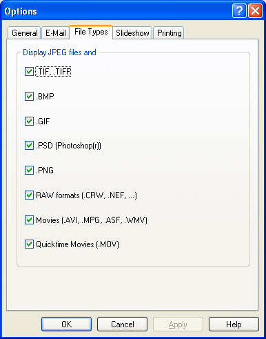

2NinerNiner2
Just updated and Picasa doesn't do 'AI. See attached screen shot from the latest version. I'll have to give Extensis Portfolio a try.
