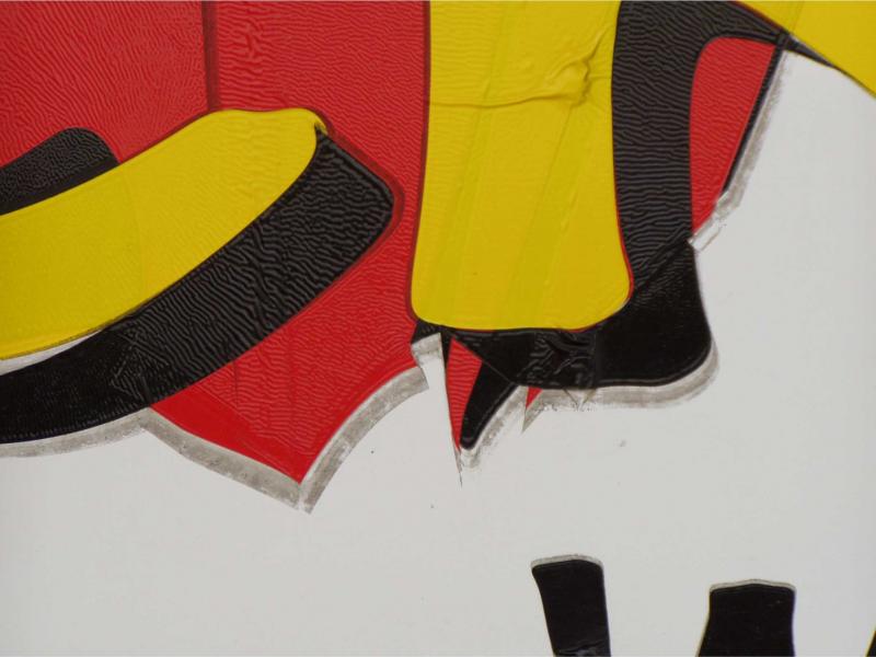

I found a picture from one job. This was on a 28' box on a delivery truck. This was two months after installation.
I got lucky on having to replace this job, the company went broke not long after this photo was taken.
Notice not only the shrinkage but the texture of the vinyl.
Yup, that's Exactly what happened to us, and the reflective issue mentioned as well on just under $200k of invoiced work. Ouch.
