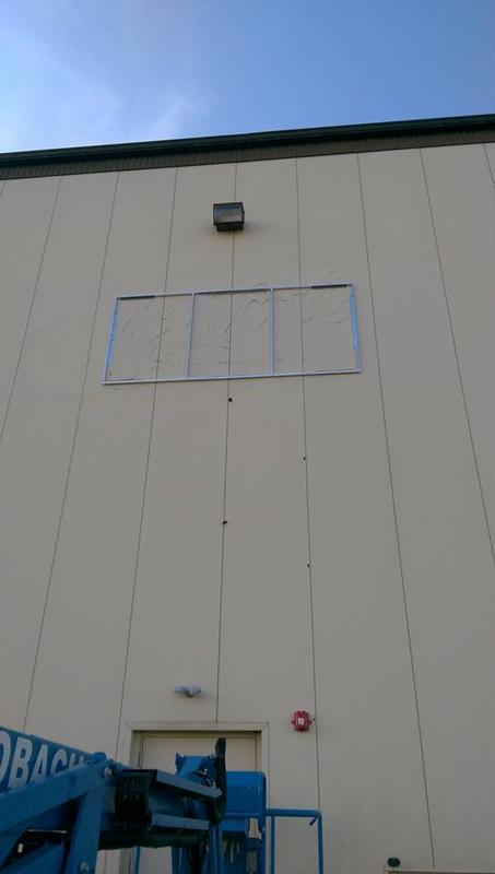

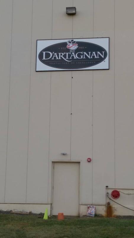

1" aluminum tube frame mounted to the building with L brackets or angle aluminum, screw the sign to the frame then i get decorative molding from the carpet department and mount that to the edges to give it a finished look

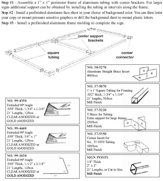

I do like this. What kind of decorative molding are we talking about? Like an L shape? And the tubing, were they attached 1 by 1 to the wall or were they secured together?

i use L aluminum brackets (angle iron or aluminum brackets from lowes or home depot) get the ones with holes. i screw that to the inside of the frame and then screw that to the building with screws and washers appropriate for the building material. then screw the sign to the frame and yes L shaped molding. basically what they use for stairs. some places only have 8ft lengths but you can get 10 and 12ft sections. if they don't have the color i need i spray paint it. then screw that in to the frame from the outside edges so it' not so visible and depending on where it's going i usually spray the screws the same color of the molding.
