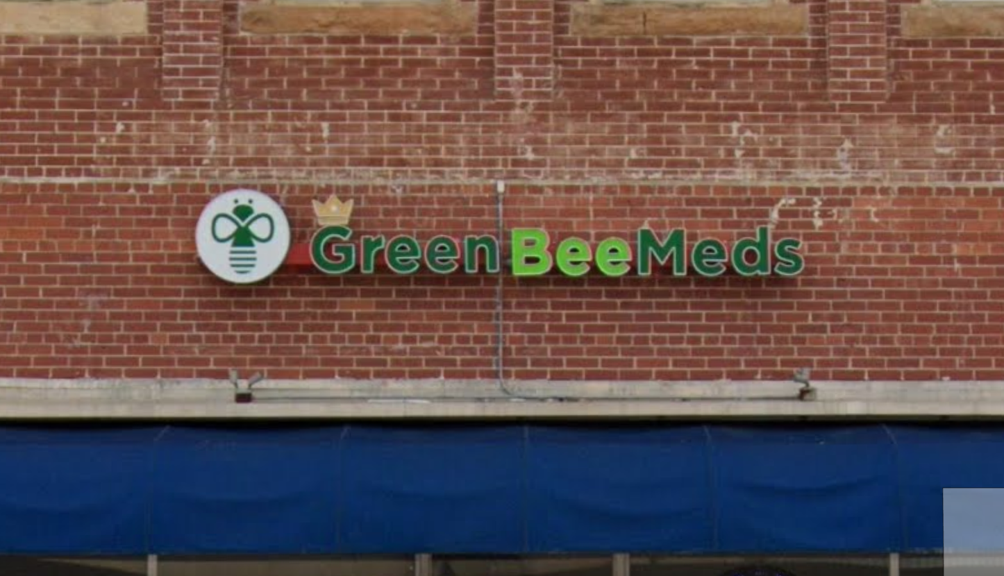

If you've seen my previous posts, you probably know that all the big sign shops around my town are gone (retired, etc). I'm the only one around wiling to do installs, but my experience is very limited with these types of installations.
This is a sign installed by one of those shops. (customer going out of business and wants this sign removed.) I don't have a bucket truck (outside of a $350/day NiftyLift rental)
Can something like this be removed by one person? Based on my extrapolation from Google Maps, this sign appears to be about 11 or 12ft wide. I don't think it can be done by one person, but before I decline this job (or refer to an out-of-town sign shop with a $1.5k trip fee)... I just wanted to make sure I'm not taking easy money off the table.
It's located in a downtown (historical) district, so getting permission from the City to even reach the sign is a PITA. (right of way planning, etc)
- Any guesstimates as to what a sign like this might weigh? 100lbs?
MikePro
oof. whatever weight it is, your reaching over an awning.
i could take it down easily if they're replacing sidewalk tile anyways :)
edited to add: worst case, just bring two ladders and figure out the extra hand part locally. at that scale, its not much weight but it is LONG and you have to shoulder it while removing hardware.
worst-worse case: you can't find someone to help you, then just disassemble it one letter at a time and the raceway bolted to the wall is only like ~50lbs.

Looks like two raceways, external lights, one man and a truck would make quick work of it. It looks like 4" raceway, which is like 3lbs/ft, letters are maybe 1lb each here, so even with a ladder, it's doable.
The real problem is reaching over that awning. Any chance they want you to remove it as well?
Reactions: 1 users
To be honest, I'd need to know how far out the awning goes, before answering. With a bucket, no sweat. Just don't see how a ladder with a pertruding awning will work. Even with your rental cost, you'd still be below an outtatowner.
Reactions: 1 users

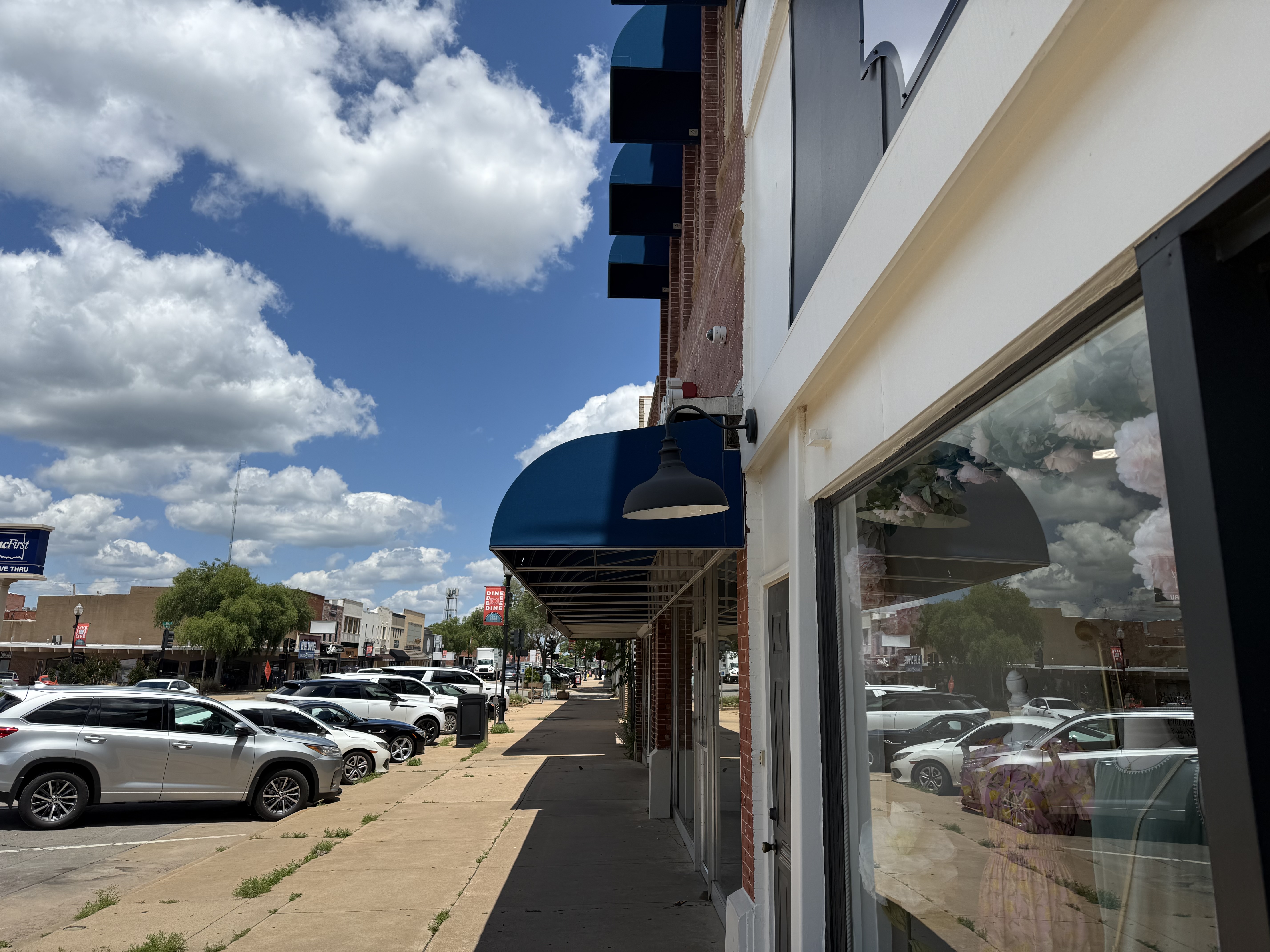

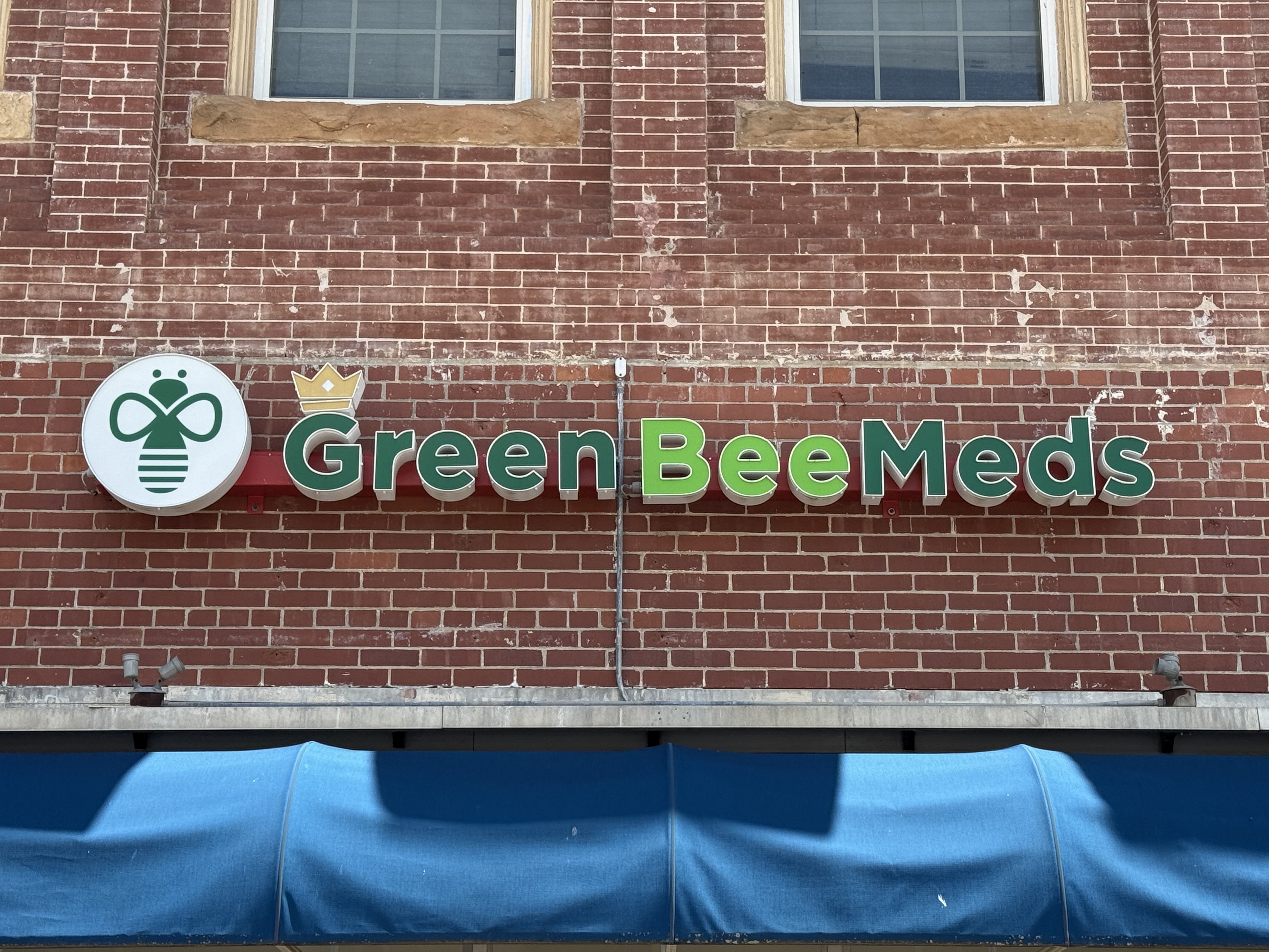

We have actual photos and measurements now.
Yep, 2 raceways, and small ledge to rest them on.
Awning depth = 51”
Bottom of the letters are 30” above the awning.
With the open style platform of a NiftyLift I should be able to access those bottom screws easily then just rest everything on the ledge before bringing each section down.
This just got a lot easier.

Oof, they are wired, and haphazardly at that. Make sure the circuit is dead before you get into the raceway. Not sure how to terminate that wiring other than shoving it back through the wall or mounting a junction box.
Did Gino really suggest standing on a ledge? I mean, seeing it from the side, it's a healthy ledge, but please don't do that.
