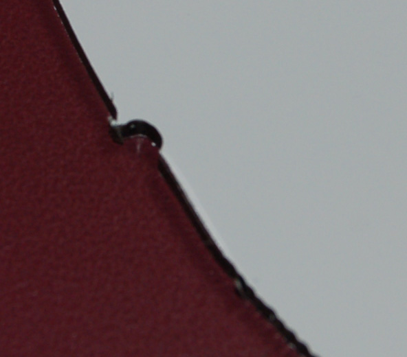

I ordered some 8" circle sign blanks for a job and got them late Friday. About half of them had bad areas like this...is this "normal"?
material is 1/8" dibond.

someone is using the wrong bit, the wrong spindle speed, wrong feedrate, not holding work down properly or a combination of any/or all of the mentioned causes...no good.

It actually looks like whoever ran the router forgot to turn on the vac holdown and it shifted. 3mm Dibond is among the easiest smoothest cutting stuff you'll get to do, it should be perfect.

get your money back or make them replace them as that vendor sells itself as being the place to go for blanks and since that is all the do, you would think they would be pretty good at it!
paul luszcz
At the risk of being a spoil sport, have you checked your file? If this is in the same place on numerous parts, it's possible that there is an extra point in the file, magnified by the diameter of the router bit, that's causing that problem. I've had it happen with a very good supplier.
gnatt66
um...it was a circle.
