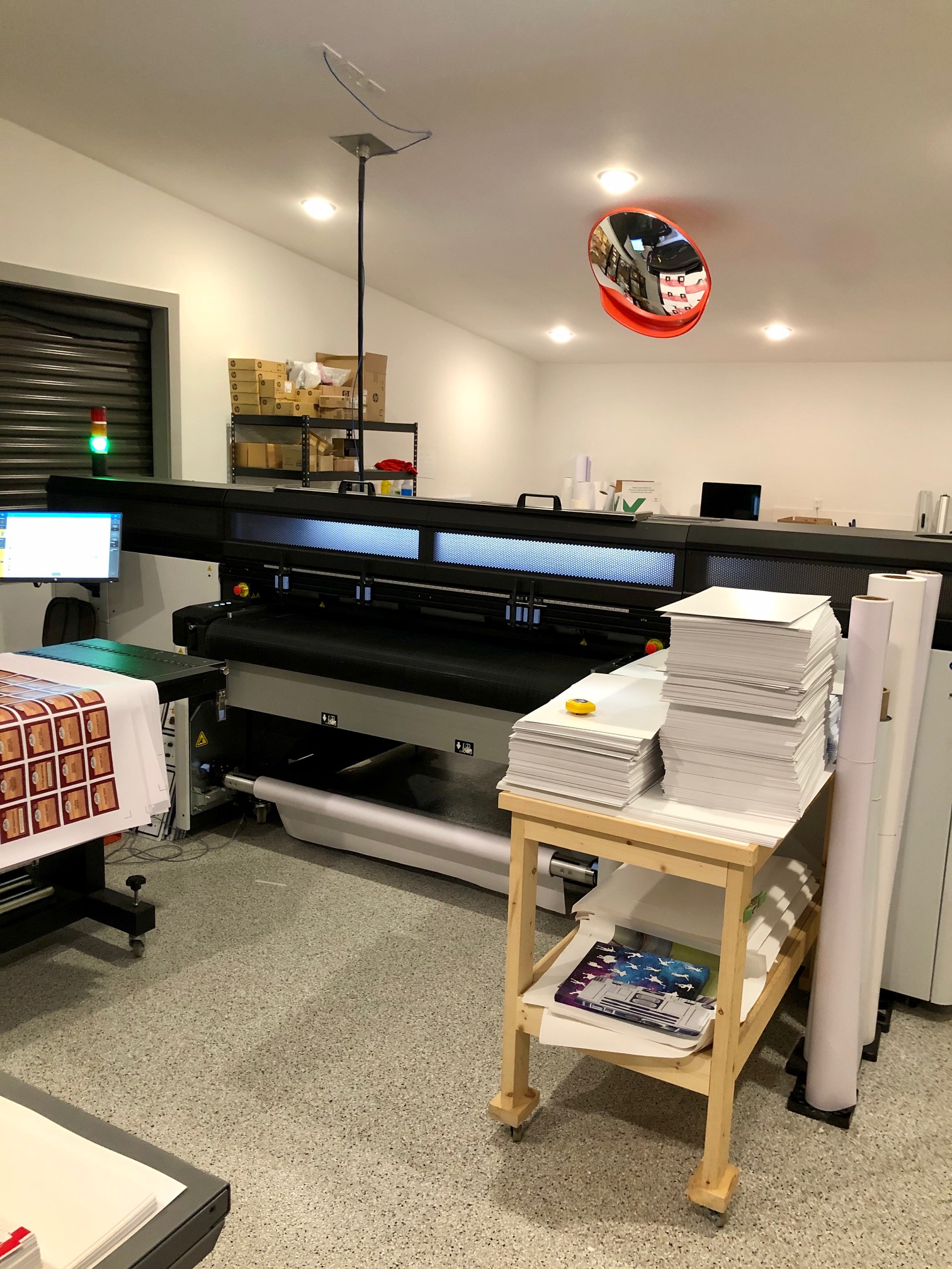

Hello everyone,
Feeling a bit chatty lately while working night shifts to keep up with a large job. Wife's running day ops which leaves me alone with my vices and equipment.
Anyway, as the title says we've had an R1000 in our shop since the first few months of US availability. We upgraded from a Scitex FB550 which we owned for a year before the R series was announced and we decided to sell the 550 and upgrade.
Being owner to new tech meant there hasn't been much I could find online when troubleshooting or researching in this last year. Even videos of the machine operating (outside of EU owners) were sparse. There is the HP knowledge center but it's still lacking for the R series.
So I'm here to answer any questions you might have. Maybe this can serve as a future resource for other R1000 and R2000 owners.
