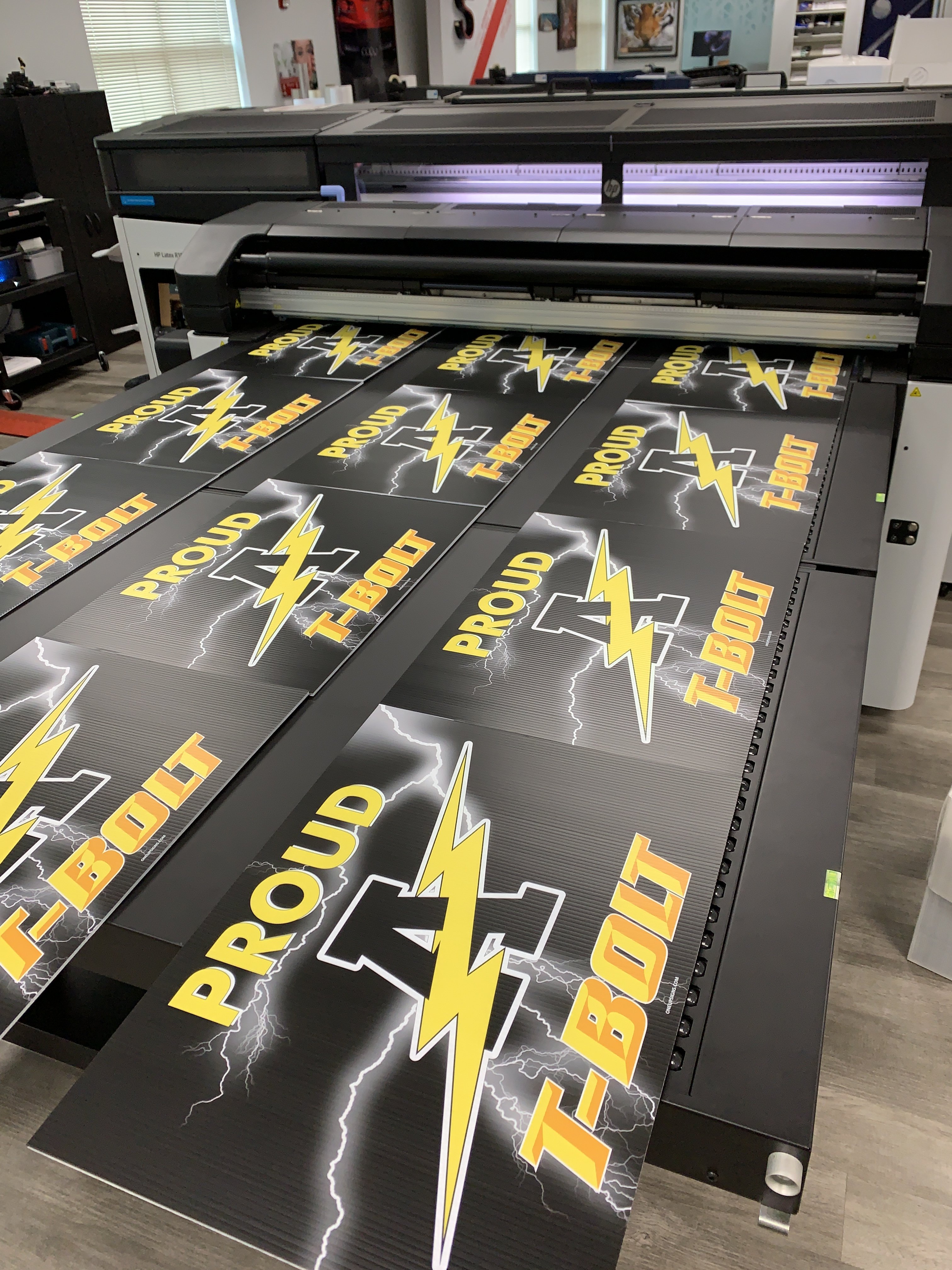

Just a quick note on print speeds. We printed about 100 18x24 single sided coroplast in about 45-50 minutes. I didn’t get an exact time because we had the head strike sensor get activated because one of the last prices of coroplast was curled. After we waited for that to clear and reload it was like 60 min. I think if you’re printing a bunch of signs for a while the print area heats up a bit so closing the curtain between the curing area and print some would help on this issue. We fed (3) boards at a time and just kept feeding it. That was on a R1000 at 3 Pass which looked like a 8 pass on my HP 360. I also heard HP is working on an update for a 2 pass mode in their next firmware update. Im sure that mode would be perfect for temporary outdoor because the 3 pass looked awesome. As I get better numbers in the future I will share.
Couple things to address here:
We can print 90 1-sided 18x24 boards in 60 minutes (3 boards per minute), on a 3 pass setting (color is awesome)
2 pass is garbage. We're always upgrading firmware to the latest beta. Yes 2 pass is super fast. But man it sucks. If you increase the density it looks....passable. 3 pass is where it's at. If you need faster then buy multiple machines or maybe consider silk screen for single and double color yard signs
What is this curtain you keep mentioning? Do you mean the curing lever on the curing module? This is only used for heat sensitive substrates, we "enable" (flip) this lever when we do things like polystyrene and things that warp very easily.
