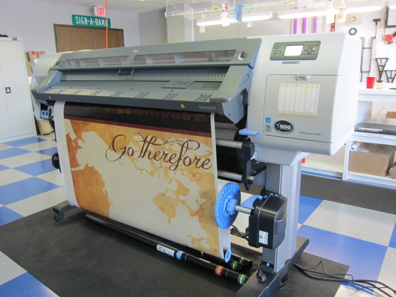

here is the print. Printed on Orajet 3640. Used the HP permanent adhesive profile. 10 pass bi:directional, High Ink. Didnt mess with any more settings. It printed 24ft in about an hour at those settings. Print came out looking great!

What's that taped on the cover of your printhead cleaning door?
Very nice looking print! :thumb:

Wow, I've bought 2 HP FB950 printers and a HP LX850 (on its way) from GSG and have never got one of those cool stickers! Wonder how I can get one for my printers!! Seriously, GSG Rocks!!!

The taped sheet is a conversion chart.
Sticker was placed on there by the GSG tech. It just has the GSG contact info.
