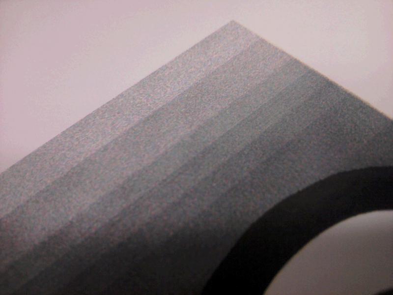

another problem i am experiencing is while printing our JV3 2500 seems to change pass rate or quality? set to 8pass unidirectional which starts ok then seems to go down to 4 pass then 2 pass and experiencing the colour getting lighter as well?

thanks for the welcome 401graphics not sure if this will work but heres a link to a pic of the problem :)
as u can see the band thickness changes as though the pass rate had changed?

I don't run a JV3 but looking at the photo I would check the rotatory encoder wheel & sensor, looks like a stepping problem with the media feed.
Might just need to be cleaned.

thanks for that i will look into it strangely have switched it to bi-directional and appears to be a lot better not sure where the encoder wheel is? have cleaned the encoder strip thoroughly so will see what happens :) cheers for the reply much appreciated

Had both of these problems happen to our JV3s. Can't remember what I did to resolve the weird pass number thing, though I seem to recall it being a data issue of some kind. I'll get back to you on that.
