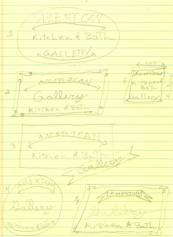

Here are the 6 sketches I made. I am not great with a pencil by any means. My hands don't want to do what I see in my head.

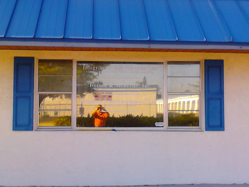

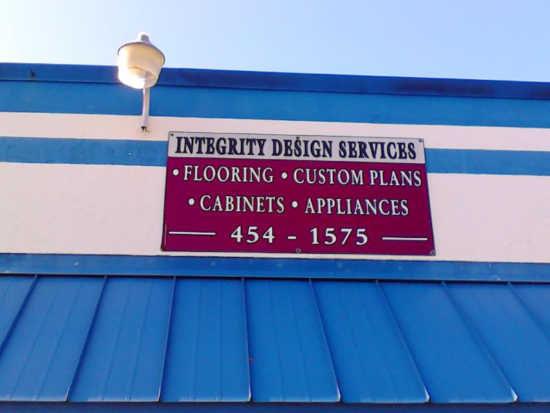

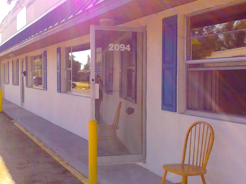

Here are some of the site survey pics.
Btw: the sign shown in the picture is the previous tenants not my clients

Justin
You should have left the 3rd pic off. You never know someon might try stealing your job! Or your neighbor down the road?
Locals Find!
I would only be concerned with that if that company in the 3rd pic was still around. That isn't my client that is an old beat up sign still attached to the building units he took over.
What is it... an old motel turned into a bunch of flea market dwellings ??
Regardless of your capabilities... mostly lack of..... your measurements don't appear to be what 's in the picture. You better check that before you go off half-cocked spinning wheels for nothing.
Oh, yeah....... why don't you let someone design this for you as you expressed in so many threads/posts up til this one ??
You can learn this stuff eventually, but why give so many clients barely beyond horrible for end products ?? You're experimenting on people paying you to be a professional and you can't even design a business card, let alone a sign. How can you do this to honest paying clients ?? Do they know you have no talent for this stuff ?? Do you tell them, they're gonna be a guinea pig ?? Do you explain they are kinda in a trap where they probably know more about what they want then you do ??

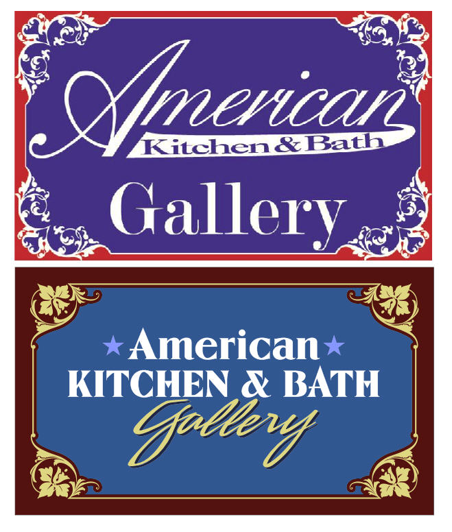

There are many subtle things that go into design besides artistic ability. All mentioned above in other post. Until you learn these things (Mike Stevens book and Dan Antonelli) you will struggle and probably never get what design is all about.
Even your concept can be made to work if you understand what you're doing. This literally took me all of ten minutes to put together. Buy a few of the books you hear everyone suggesting on this forum. I think you'll be wasting time and money on some course taught in a college. They aren't specific enough to the sign industry.
Good for you... I was starting to lose faith, as I read this thread and saw another computer effort... but you at least put pencil to paper, so I will too.
So far, my first observation is that one layout does have something none of the others have... 2 things actually...
On my phone, I can't see it while I type, but I think it was #3 with the banner/ribbon on an angle. It is the only layout with asymmetry which isn't exactly working (yet) but at least you stretched to find variation in your attempts... Which is half the battle... Thumbnail sketches are a visual form of "brainstorming" and the point is NOT to simply get your hands to " do what you see in your head" ...that skill will help, when you develop it, but sketching should be loose enough and quick and uninhibited enough that you discover possibilities that aren't in your head...
The other characteristic in the one I mentioned above is "dimension"! By using an overlapping of elements, you create depth... It's weak, and I'll be honest, none of the sketches have much potential... but it's a start and you didn't waste much time exploring them...
I will do 6 sketches too, but it can't be right away...
Hopefully you will do 6 more... and feel free to steal concepts... In fact, remember when I posted half a dozen business cardswith logos I've done, on one of your threads? ...back when you said you would just give up designing? Well go find that and steal my concepts, and do 5 minute sketches of your copy, borrowing styles you see in other layouts you like...
