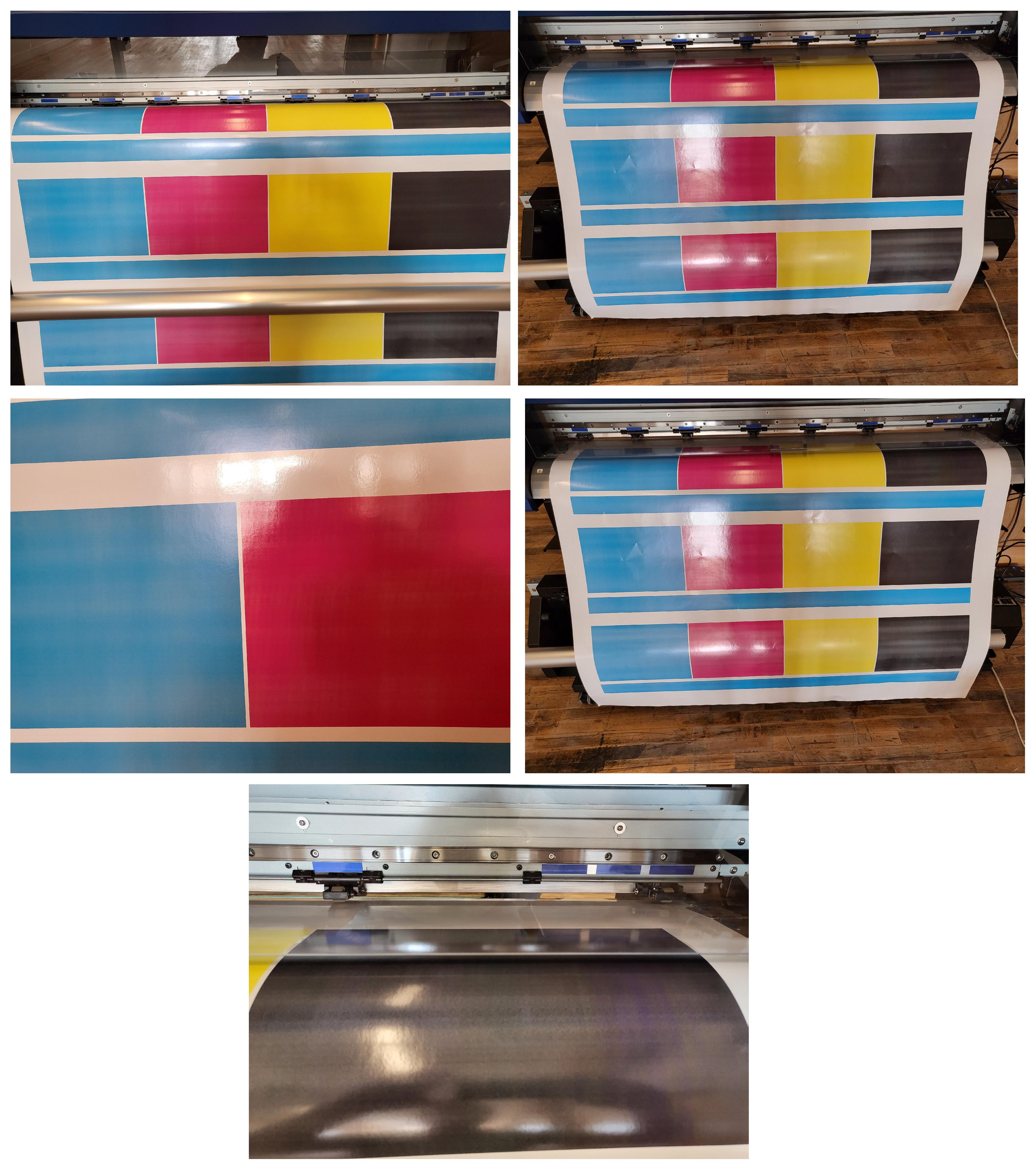

here are some images of the quality of print I am getting if this helps anybody come to any other conclusions
weyandsign
Click on the start menu, goto Versaworks, and right click on "Initialize Application" run as administrator. It will wipe out all the settings in the program, but I've seen it fix something like this before.
