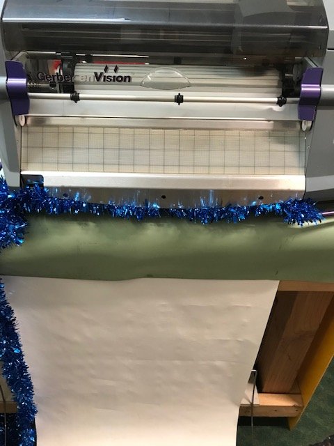

Don't hate , it works - many years ago when visiting a buddy's shop he had this on his printers / plotters for static .
**MUST BE GROUNDED !!** I laughed because it was June and he had X-MAS tinsel on his machines but he had no static . I've be doing it ever since on mine . I have one grounded to a UPS the others to a grounding rod . "cheap fix for a major problem" he would say

agree
the method above ( x-mas tinsel ) only reduces the static created from the vinyl traveling not the machine itself ( so many plastic parts now a days ) -
