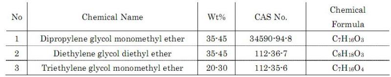

attached is the msds for ES3 cleaning solution (mimaki eco solve). again. same base materials every time.
