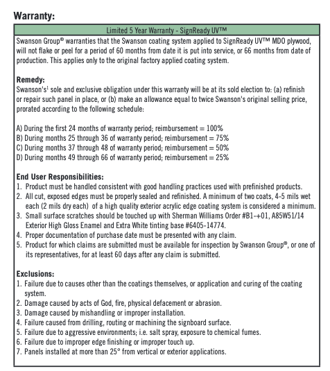

We have been using 1/2" MDO for years on site signs and it works well for those applications. For long term use, I know they recommend using trim cap, which for a square or rectangle sign is fine but a custom cut one not so much. The manufacturer offers a warranty for up to 66 months on the product. We have some permanent exterior signs we are going to use them for that will be custom cut so we will fill fill any small pin holes on the edges and primer them. What other substrate would you recommend that's 1/2" for an exterior sign like this? I know we could use 6mm max metal but that's a little too thin for these signs. I would think with properly sealing the edges the sign would hold up 10 years but it is still wood so if anything falls on it or chips the edges, moistures will pour right in.
