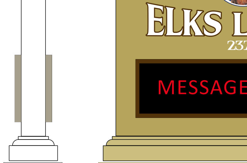

I will check into both Dak and Watch. It's for an Elks Lodge so I haven't found out what their budget is yet. But I want to give them a couple of options.
I'd like to see if they can build with it going through both sides of the monument wall which is about 6" on the face.

They're always one-sided units. I think the thinnest I know of is about 7". That would be a total of 14" if smack up back to back. Usually you want a little breathing room in there for maintenance. Any of these companies mentioned will explain how it works. You need to build it so you can remove it in case of something going wrong and needing to get in there.
We were working on some face replacements in a pylon sign about 2 weeks ago and the LED was on the bottom. If it ever needs work done on it.... other than bulb replacements, I pity the guy who has to climb in there, as they didn't leave any wiggle room for maintenance from the front and the sides are cemented in with about 1/4" space, if that. The closest removable panel is about 24" above the unit. That's a long reach when you're up in the air.
