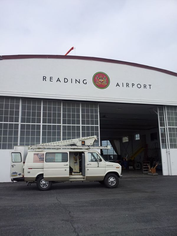

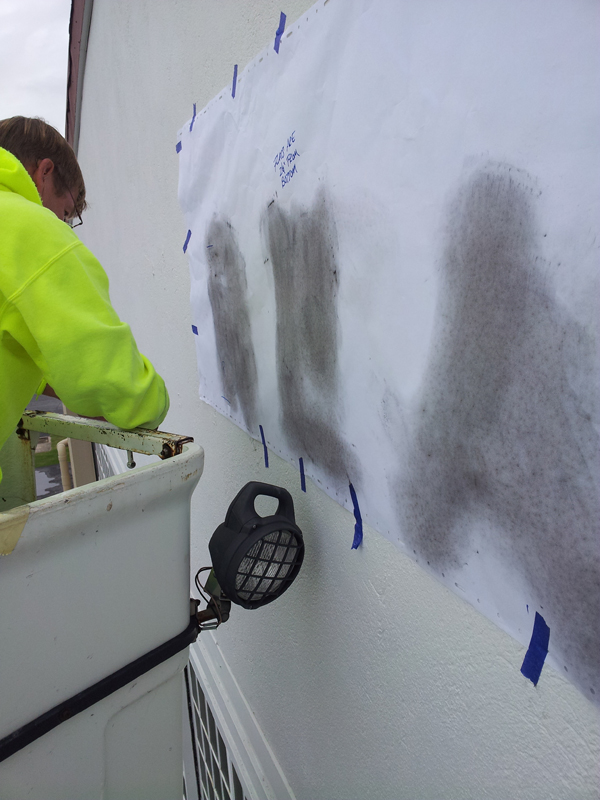

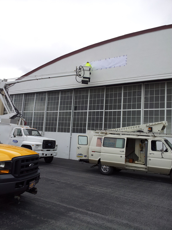

Well, as many of you have claimed I have not posted work, so we’ll start here. This is something I hand painted about a week ago and then finished off the seals and hung them yesterday, Wednesday.

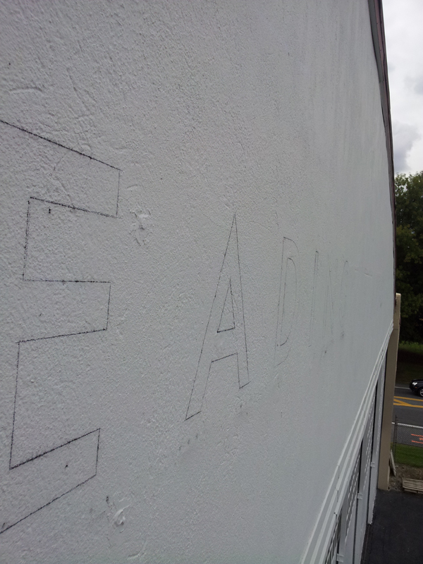

The first pictures show putting the pounce pattern up and going to town on it, after figuring out the spacing needed for the circles.

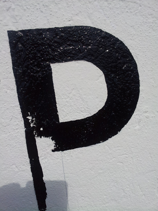

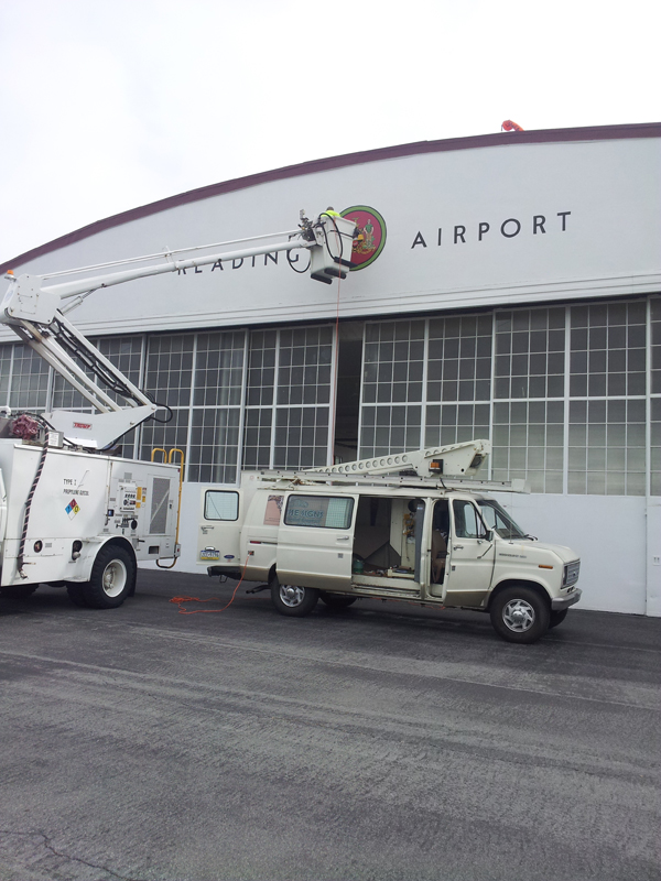

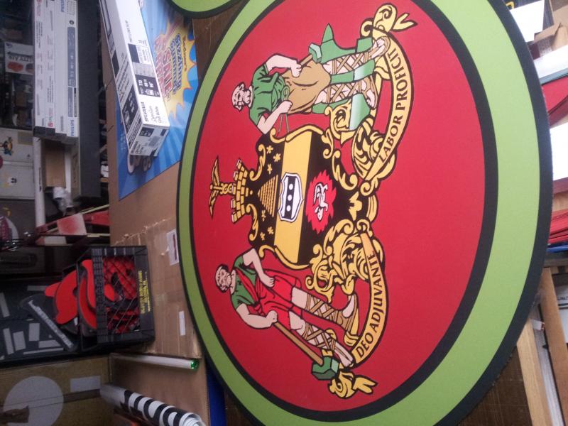

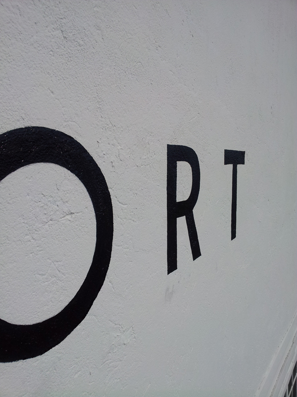

The next shots show the poor condition of the wall for painting, even with a fitch. I used a good fitch for the first letter or so, then went and got some raunchy pig bristle brushes and gave them a haircut. After that, things just cut in fine. Took about an hour to hang the pounce per side and about an hour and ½ to paint each side. The 5’ circles took about two hours to hang the first one and about 20 minutes for the second side. My helper was one of the maintenance guys from the airport using a de-icer truck. He got called away on an emergency during the first one. The circles were flatbed printed on the outside two black and green circles and the rest was painted in and then cleared all together. Got a good price, write up in the paper and lotsa recognition.

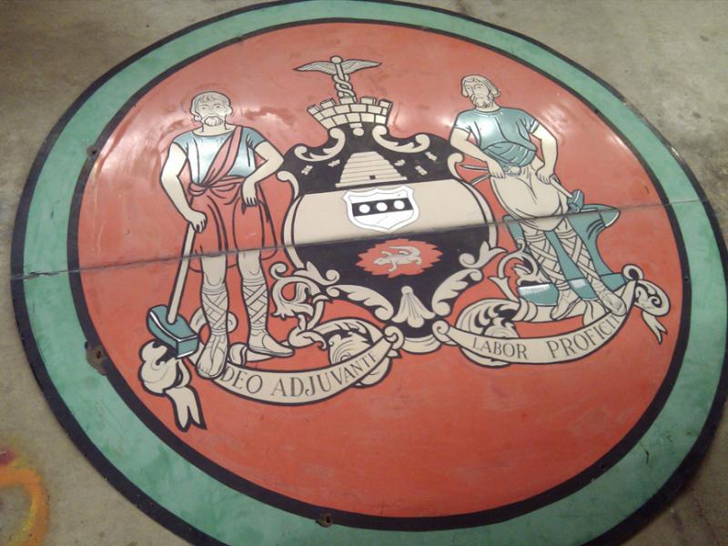

Also, here is what it looked like 75 years ago. We’re involved with the 75[SUP]th[/SUP] Anniversary and they wanted it to appear as it did back then.
The only thing is, to save money, they reduced the original size down about 18% and the overall image is slightly smaller. However, not many people from 1939 will be there to say argue.
