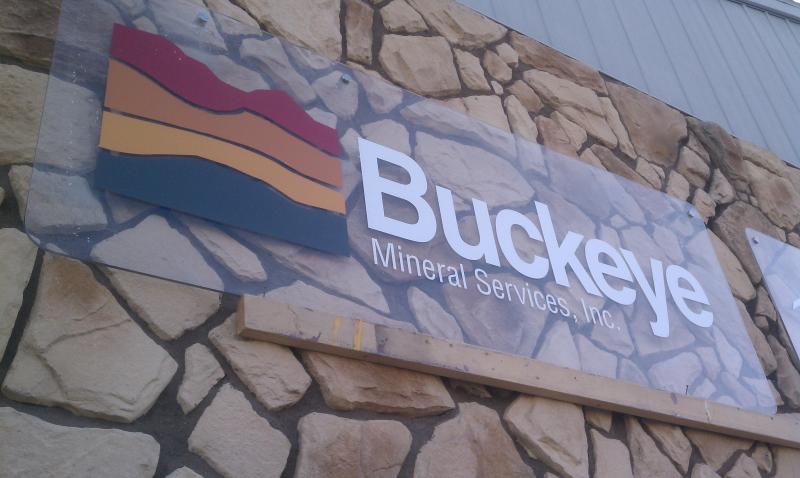

Why not standoffs? If it were me, I'd request to double up on your allowed holes in the wall. If you need to make some holes, make sure they look nice. I just finished something similar and we used 3/4" standoffs with a hole in the acrylic twice the size. thought this would be enough for expansion. the blue concrete screws are rated at 200lbs per hole, plenty enough to hold.
This is mid install. The board is to hold it in place. The standoffs are so far on the top only.

Am I alone in thinking that is very bad advice?
NO!!!!! BUT............IF, the owner of the building doesnt want holes in the brick/block, and how long is this sign going to be up there? short term it will work, couple years, the motar once you drill a hole, attracts moisture, thus making the motar soft. holes in the motar are more easily patched.
