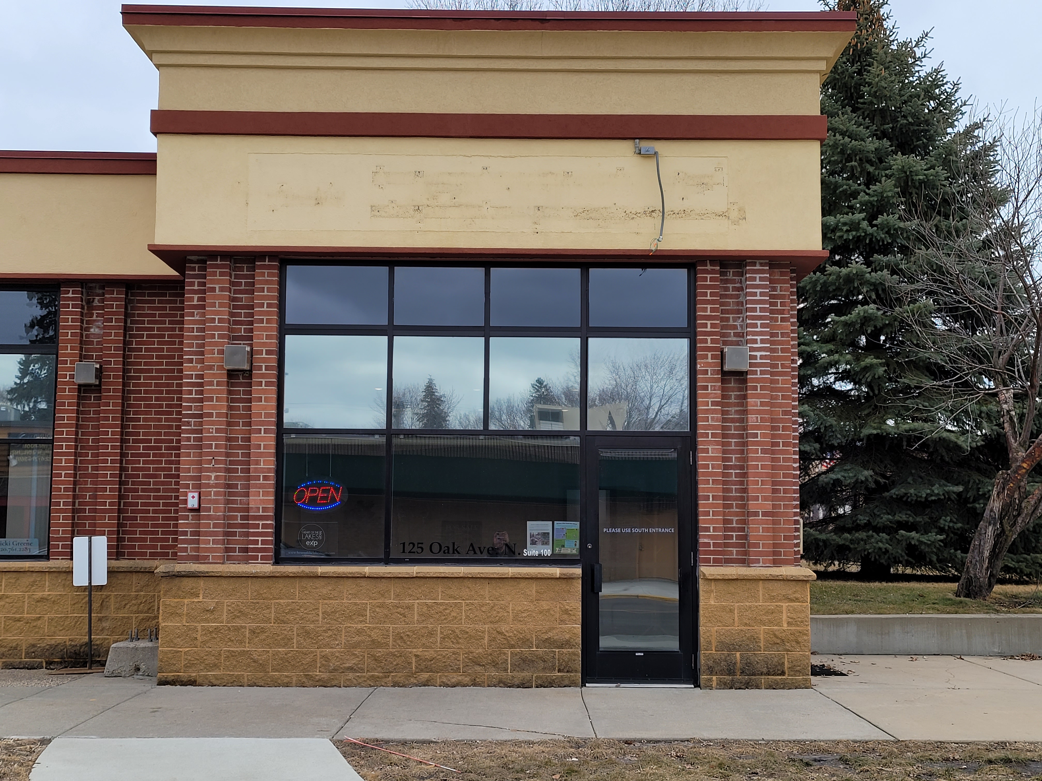

I ordered cut acrylic letters with posts for mounting in a brick wall. There are A LOT of letters, many of which are small, and the client has decided they don't want that many holes drilled into the wall. So now I will need to mount the letters in a runner of some kind, and mount that to the wall using just a few mounting points. So what type of runner should I use? They are just white letters on a red brick wall.

I would do a painted, stud-mounted aluminum panel(s). Red letters, especially small ones, on a (presumably) red brick background, are going to be more difficult to read.

I'd lean towards aluminum mounted with spacers or made into a pan like a raceway and painted black.
You could get fancy and take a picture of the brick in that same spot, print it, stick it to the aluminum and then mount your letters.

paint the backs of the acrylic letters with 2 part epoxy primer and you can silicone them to new substrate and not have to drill anything
I would use a latex painted aluminum backing with a color that complemented the brick and silicone the acrylic to it

I would have to see how big these letters take up in space and layout to the wall space before giving any advice on mounting to runners. Mounting letters to runners that do not match backgrounds can be ugly.

We use whatever we have in the cut offs bin, aluminum, ACM, flat stock. Paint to match wall.
