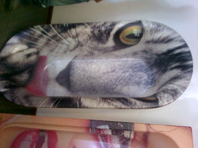

UV Ink - Thermoformed into a Bath Tub
artbot... you might appreciate this, Our Oce' principal in SA - has formulated this ink, reverse printed it on plexiglas and thermo formed it into a Bath Tub...

awesomely stretchy ink. i can only imagine what kind of pimped out bathroom a leopard tub would go in.

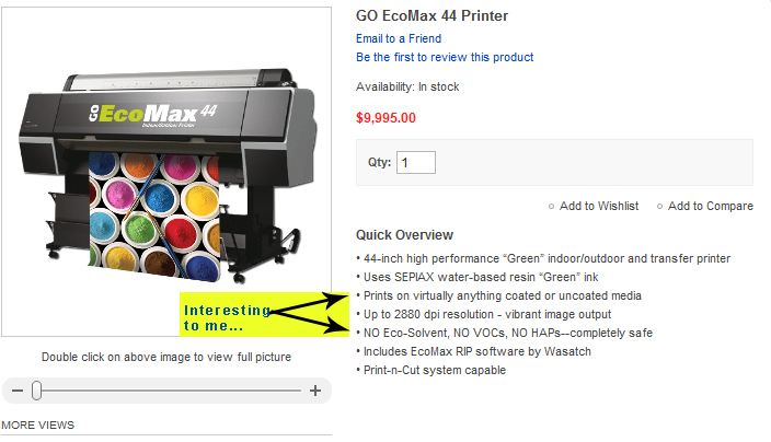

This seems pretty green. Anyway, not a bad price for a small shop.
This is being offered by the USA master importer of the SepiaX ink. The machine itself is an Epson Stylus Pro 9890:
http://www.epson.com/cgi-bin/Store/jsp/Pro/SeriesStylusPro78909890/Overview.do?BV_UseBVCookie=yes
What I am curious about on this machine is the fact that it does not have heaters that the SepiaX ink needs to properly dry. Unless Graphics One (importer of SepiaX) is retrofitting significant heaters into the Epson, I can't see how this setup works with the SepiaX inks.
In any event, the latex ink fraternity is being joined by Mimaki this month, so it appears that regardless of the specific ink chemistry, or the marketing jargon being used, variations of water-based inks are destined to replace solvent and potentially UV inks in the future (in my estimation).

The machine is an Epson 9700, and it has been retrofitted with a heated platen system. It won't print on every material (the machine itself won't accept materials over a certain thickness anyway) but it does run adhesive vinyls, banners, tyvek very well, and can still print on all of the aqueous materials. Even offset poster paper works nicely.
Mimaki went with calling their ink latex, but I've heard it's more like SEPIAX in that it cures around 50-70C, while HP latex requires around 100C.
