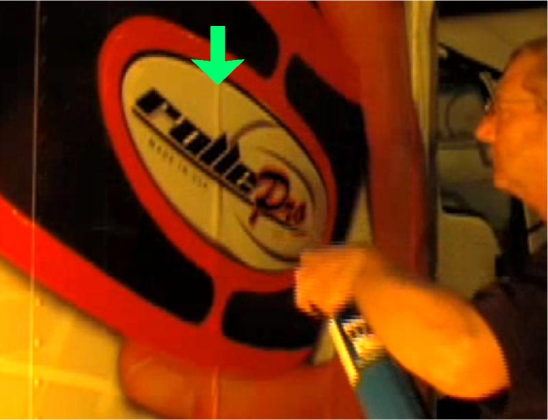

we wrap 53' semis in 3 hours.
its all thanks to the rollepro. it took what was hours and hours of hand numbing missery down to minutes.
learn the technique and you will never look back, nor will you be so happy as you will be when you realize what a time saver it is.

Looks great I have tried using the rollepro and it is a great tool I just could never get them to lay down tight enough especially after seeing them in a couple weeks.
