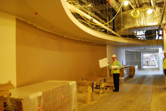

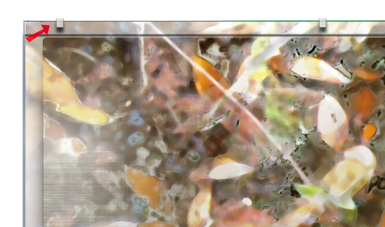

i have a 211 x 38 diptych to do. two layers. metal on the back, acrylic floated slightly larger about 1.5" over it with a second image mounted on the front of the acrylic. the wall is slightly concave.
usually i would print the top layer on a .040 PETG and mount that to the acrylic using a special clear epoxy. keep in mind this is a textural print that looks like melted glass. the image can not go on the back of the acrylic.
the epoxy will not cure fast enough, also i don't trust it for the next fifty years being concave. it's a tricky material that i do not like using.
