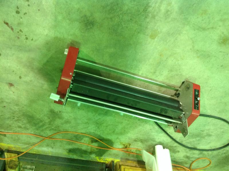

I stumbled across a deal on craigslist that seemed to be too good to pass up. USI 27" laminator with heat, $120. The guy said if it doesn't do what I need it to do he will take it back. It isn't fancy, but I think it will work for now. Anyone have any experience with these?
