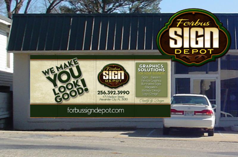

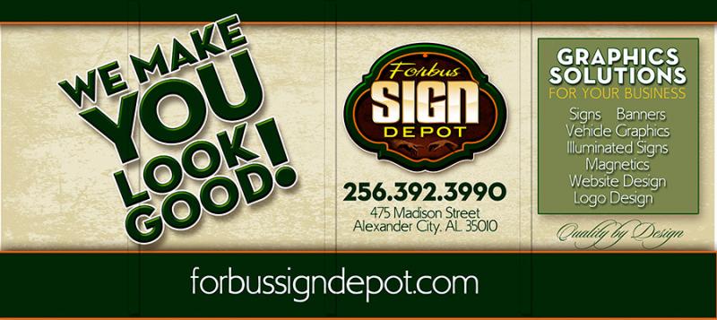

new windows
i'm just working the windows right now... will get back to the van.
on the windows i changed the font for the list... removed the yellow, added dark green, and moved the web address.
the windows i didn't feel needed the logo or biz name real huge because of the large sign i will put above the door.

Jillbeans
I like that better.
And I agree, I don't usually like light on light.
But it might work.
Looks way better without the yeller and with the darker green.
i'm thinking you could make your web address bigger and bolder reversed out of that band on the bottom for a little more effective use of that spa..you may want to try it in another font but also in all uppercase so you have uniform height characters to work with / no decenders.

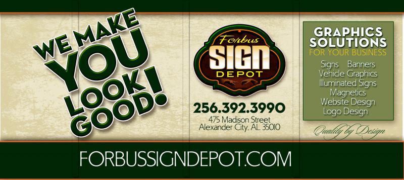

here's the windows with a bigger web ad

Would it be worth while considering putting the web address along the top of the window? if as was mentioned cars are parked there. it may be slightly better exposure. I also agree with the readability. Try it upper and lower case. and try making it fill the space a little more.
Im still not loving the font you used for "Quality by Design". I would consider making something like a STAMP (ink and stamp type) and do it RED and have it at an angle. it may have a little more impact.

Jillbeans
"Design" need to be a bit closer to Quality.
And it should be the same script as in yer logo.
Looks a lot better tho.

luggnut
oh... jill!!! i love that fancy script though!

Just a thought: if you look at all of the designs that you presented, the only one in which your logo pops is your business card. I would consider rearranging things on your building sign and vehicle wrap to make your logo more prominent. Your logo is also your name, after all.
Rick
This is some really good design, it's refreshing to see this quality of design.
Your city must have some very loose sign rules, here in California, I don't know any city where any of this would fly with some code enforcement hassle.
You can't look at your windows without looking at your huge massive entry sign... over here we are usually allowed 1 -2 square feet of sign to every linear foot. Your sign is big enough where your window graphics may not need a lot of branding. Most window graphics are made to give the building a sense of place and in your case a branding opportunity, I think you are doing that even with a huge tagline, where you miss the mark is your van wrap is like the window, your van wrap might need an equal read or you may need to emphasis your identity more.
I don't know if people will read the copy, to me it's overkill... it's not hurting anything but it looks more like a brochure than window graphics. I don't think you need your address on your window graphics. I agree with Gnmmas, I would cap parts of your website on the window graphics to make it read easier and probably make it easier to remember. I would also put a dot between "SIGNS • BANNERS" to separate them better on the window graphics.
What does it look like from across the street? I'm thinking the tagline and the sign is what will read best, it's possible your sign may be disproportionate to your store frontage.
Is the sign going to be a flat panel or dimensional?
the bldg will have the large sign on top so it would be to much to have it large on the window right beside it. did you see the first post with the mock up of the storefront?
i agree about the van and will rework it.
Rick ...thanks for the compliment, you are a great designer so i am really flattered.
the sign will be a flat digital print i already have it from the previous location.
and i gonna redo the van wrap design... i agree i need to brand it better. and i meant to put the dot between the words"signs Banners"
