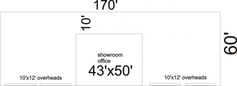

Well folks, here is my interior layout, I do have about 3200 sq.ft of upper level storage, scirrors trusses, so walking is a breeze, will have (4) zones of radient floor heat, natural gas, 3-phase electric, and finally a nice showroom to display floor, wall, ceiling graphics, as well of display units, I am keeping the dust from the CNC Routers separate, but with overhead door for easy transport, coming and going, again, any thoughts are greatly appreciated...........:thumb:

with 170 foot long building, and as you have with the showroom/offices on one end.......makes for a lot of walking. i see this drawing an rendering from the builder............have him do one with showroom/offices in the middle, and a 10 foot connecting hall way to each side at the back of the office/showroom space. you loose 10ft of showroom/office but workflow is better.
