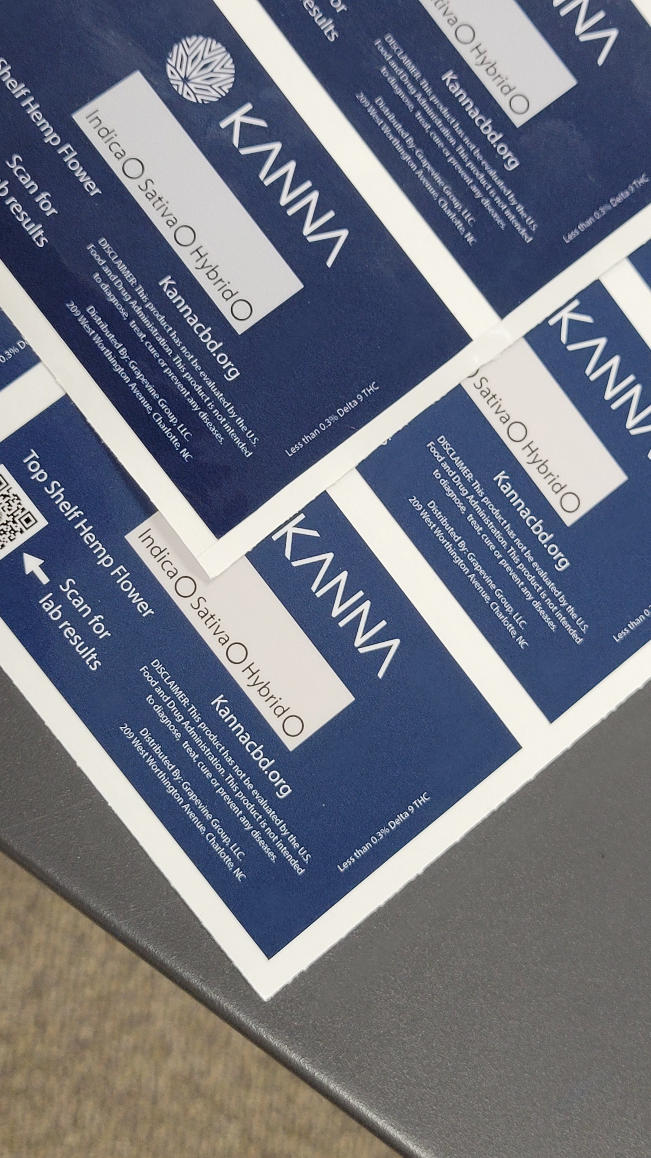

I have a few decals we print on a regular basis that are heavy coverage with small knockout white text. On my 310, the text was pretty crisp, but off the 700, I've got fill-in/fuzziness. Printing at 600, 6p. Stock is 3M 40C.
There's multiple ways to tackle that but the reason is you are doing heavy ink load fast.
You can change to 8pUNI which is slow but will probably make it look perfect.
Or you can increase OP a little, increase printzone heat, add small interpass delay, lower your max ink, change to 8p etc etc. Many ways.
Edit: Actually maybe that's not it. Now I feel like it's not feeding correctly. Anyway either one.
What is the print direction?
Just for the sake of it, I would take out the OMAS lens and clean it. You can remove the piece of glass from the holder and just make sure it has no haze on it. Put it back and don't touch it.
Similar to what the guy who did the install said... I just haven't had enough time to play around with new print modes yet to experiment (no difference between 6p and 8p though).
As a follow-up, alignment definitely needed tweaking. That got rid of the magenta haze. Still a bit fuzzy in the text so I'll play more after the holiday.

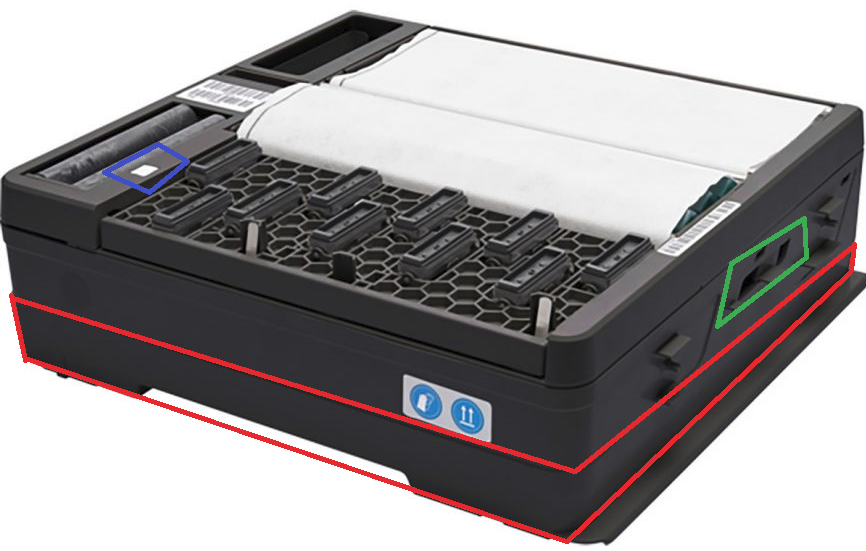

A little tip for you guys who are already using the printer. Especially if you use a lot of white ink, you can possibly even double the life of your maintenance cartridge this way.
Because it stores the waste ink at the bottom, it doesn't always completely use the cleaning roll.
By removing the waste ink from the bottom (red) and resetting the flag (blue), you can use the full amount of the cleaning roll in case there is some left (green).
Just suck the waste ink out of the bottom and discard it. Put a piece of (preferably paper sticker) vinyl on top of the old if it's not white any longer. And check the remaining amount of cleaning roll from the window.
Now the printer will still know approx when the cleaning roll is ending because there is a flag there. Usually the usage is just limited by the waste ink (especially using white).
I do recommend doing this before hitting 0% as you risk ruining your new part of cleaning roll if the waste ink touches it.
Adding to this, also scrape off the ink from the two spit rollers. They tend to get stuck if there's a ton of ink on them.

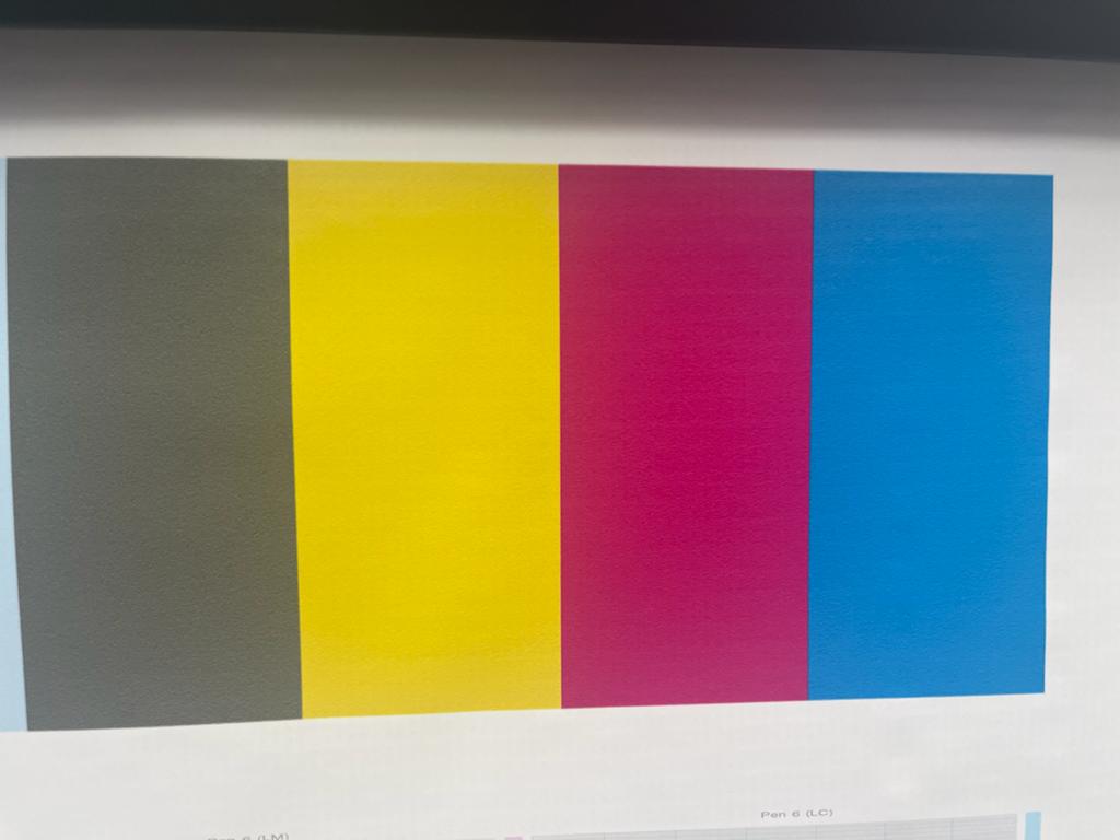

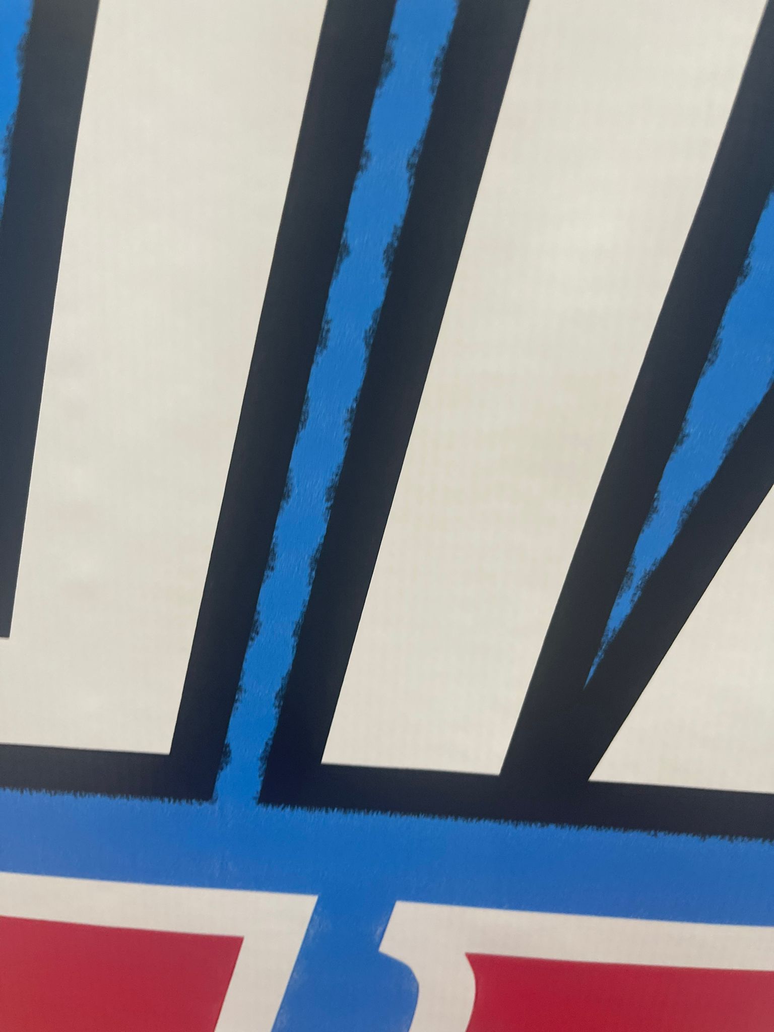

Start seeing these fussiness in the print and some white spray type spotting any idea what could have gone wrong. Do you think its a optimizer ?
That has likely something to do with OP but I'm not completely sure if it's broken.
Are you sure the profile is dialed in perfectly? There is this two settings for extra optimizer at the edges and I recommend to have both set at 1.

IT was running all fine was doing roll after roll it just start happening from last 3 days
Hmm well it could be the black or OP. I would try to investigate a little more before replacing but at least print the nozzle health check plot and see if anything is clearly wrong.
Then there is more tools behind the service menu like drop detection which helps sometimes but you can't access it. You could ask your reseller to remote in and check it.

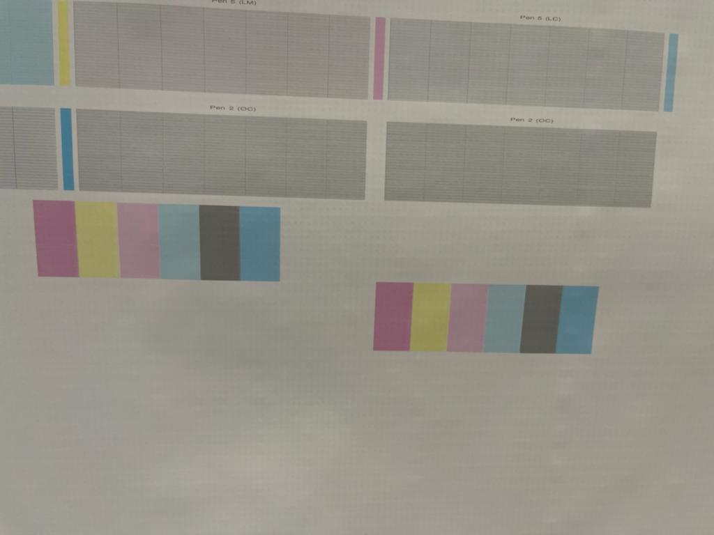

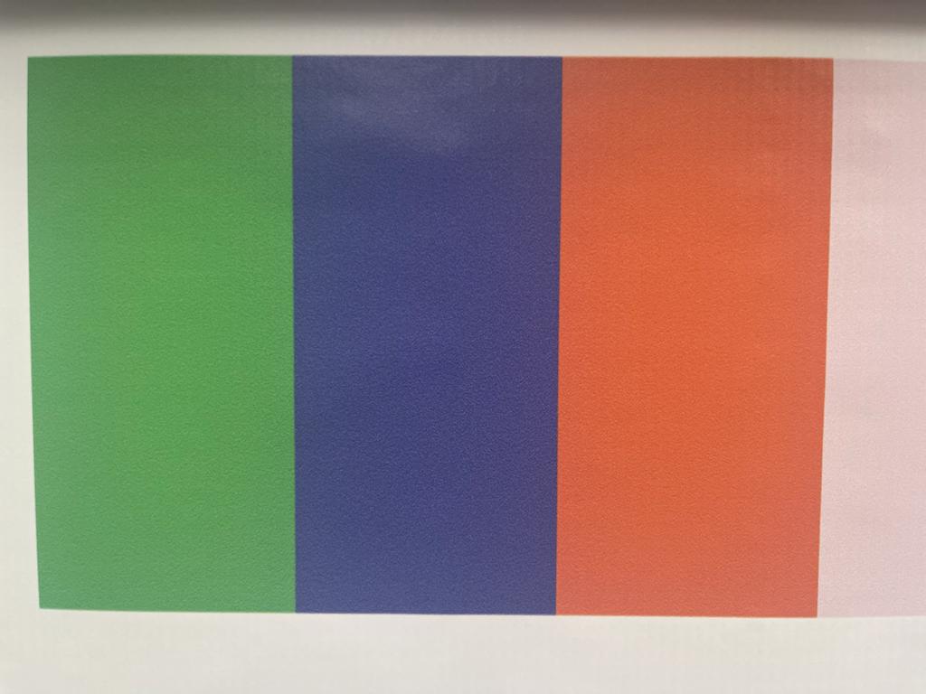

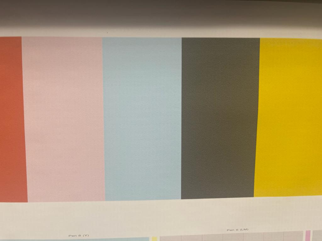

I opened the case with hp to see if they can send someone in the meantime I did get the op head in stock. I did check the Nozzle check other colors looks fine to me. Also if you can take a look at these pictures as well ?
