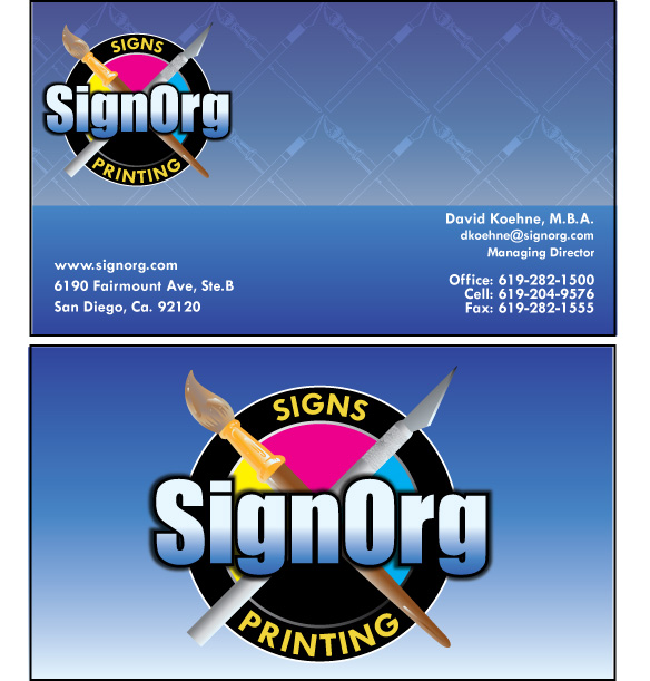

I have re-worked it since my last post, here is the updated and a proposed layout for the b/c, let me know what you think. thanks.

i remember your first go at this ... the new one here is way better :thumb:
i might make the fade in SignOrg not go to such a dark blue ... or maybe make it solid white?
but its a pretty good job,

The "g" needs nudged closer to the "r" in "Org".
Maybe it's my monitor but the colors look really washed out/muddy.
Light sources seem all over the place.
"SIGNS & PRINTING" would look better in white.
Love....Jill

that looks nice! just fix the kerning as suggested. I like the repeat fade of the crossed brush and knife.

how bout "signs &" up top, "printing" on bottom...empty space kind of weird
I agree and the first thing I see is the big grey space between the handles. Maybe an est. year or something there? Also, from a typical customer POV I think the info on the back too tiny to read.

Now the knife and brush need a black outline to tie them in.
Colors look a lot better and I like the SIGNS PRINTING broken up.
But now you have a big black hole in the bottom.
Not sure how to fix that.

thank you.... changing it from grey to black didn't help it. that's the first thing i see.
