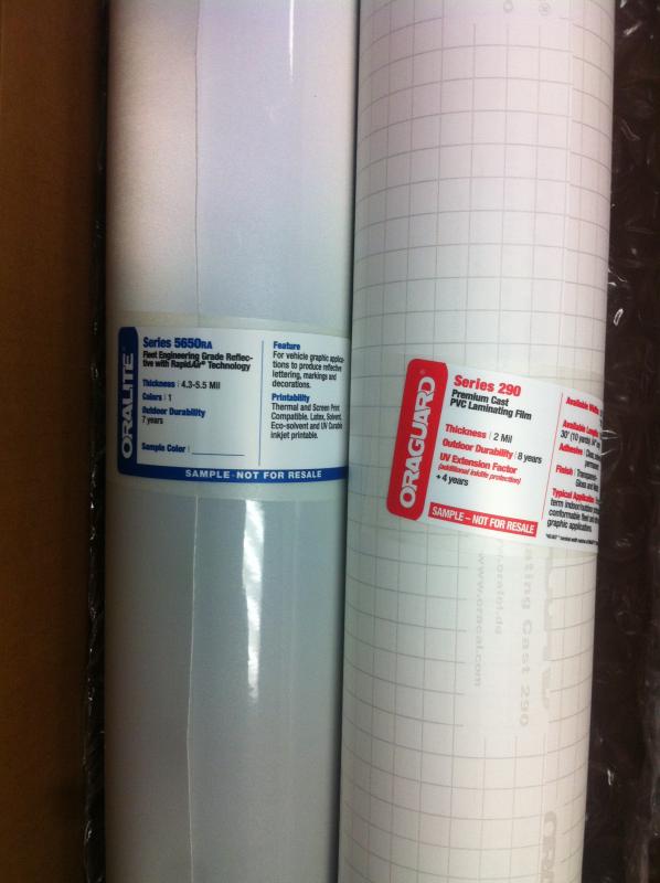

So here's an update on my progress with Oracal. I received a sample roll of their 5650 reflective vinyl in the mail today along with a sample roll of the 290 Overlaminate. I didn't receive the full roll of 5600 to replace the failed decals for my customer like they said though.....
So the 5650 is the same product except it has air release. So basically it solves none of the previous issues but I guess they are trying to sell me on this new product. AND the laminate isn't cheap if you consider it has to have an equal lifespan to be worth applying because apparently their reflective vinyls are only as good as the laminate you apply on top.
In conclusion there has been no progress.
