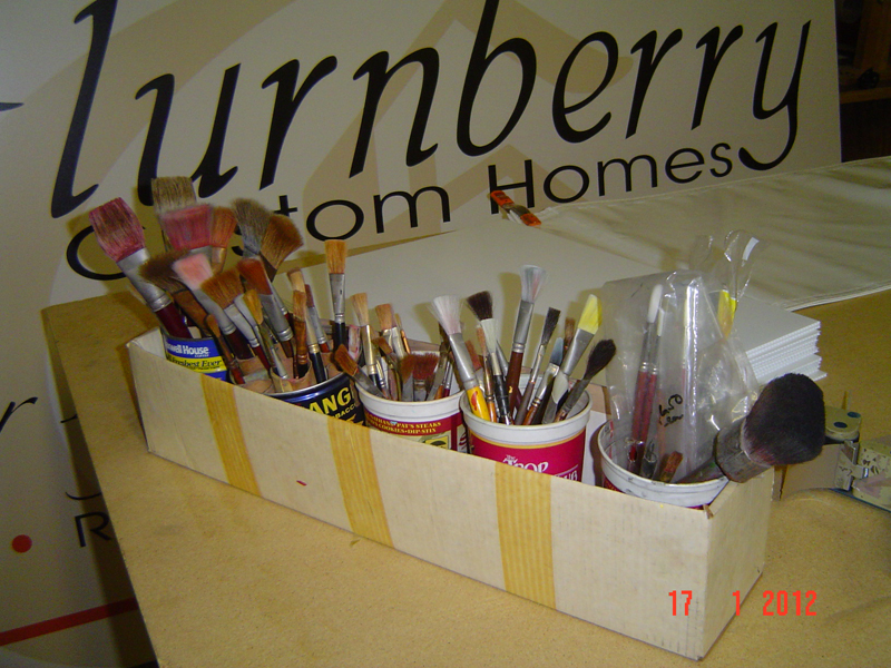

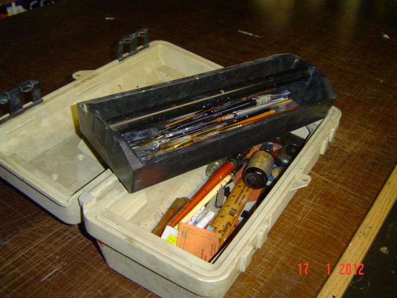

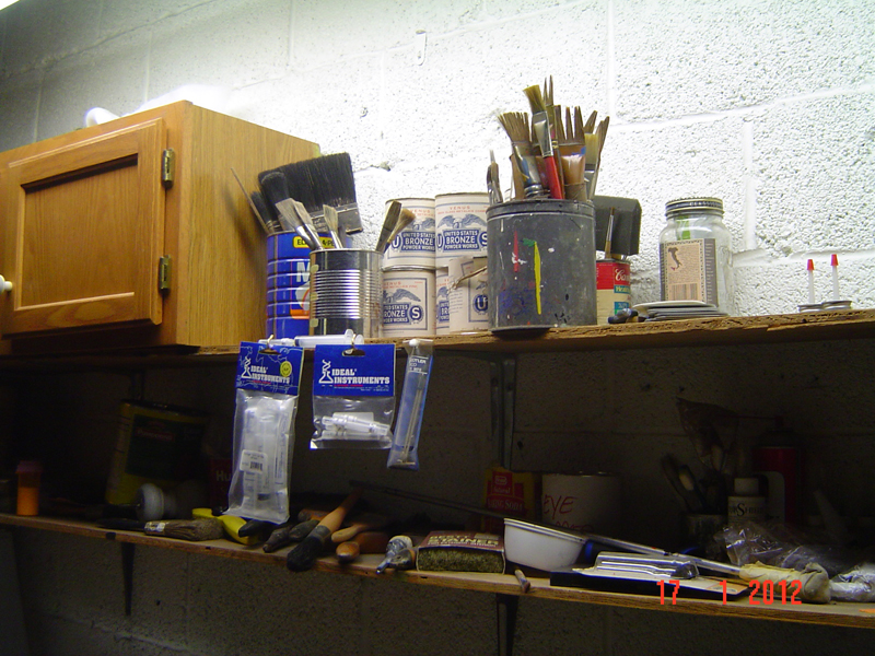

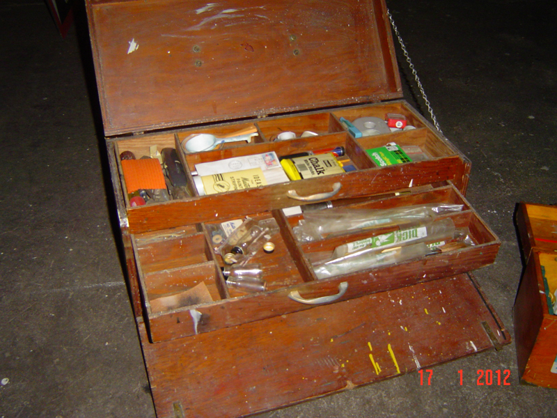

Here's some water brushes for lettering posters and shocards, oil brushes for almost anything else, retired brushes for lettering odds & end things like sandblasted signs, backgrounds and pictorials and an old traveling kit which can hold pretty much anything. You can see some of the bags say Dick Blick on them.
