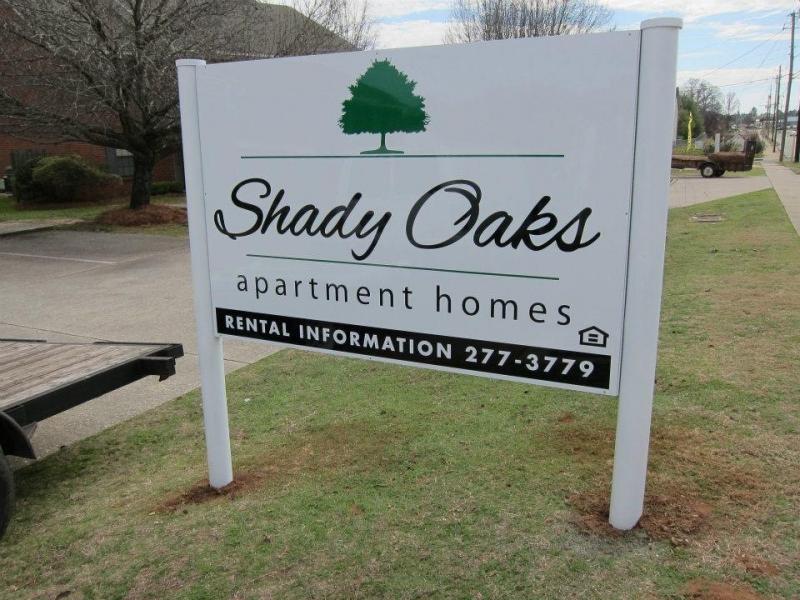

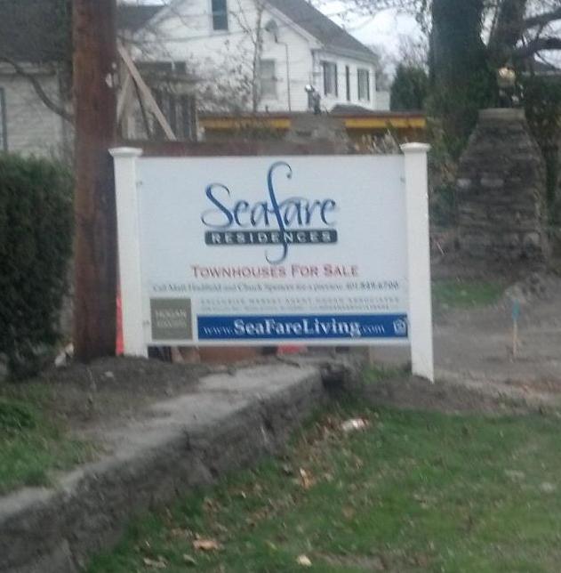

HillHouseGraphics
I use a local fence company, who has 4x4 pvc posts and caps and they will slide over top of a pressure treated 4x4. They look pretty good and are sturdy. Any fence company will have them.

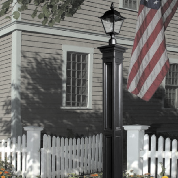

elegant dual pole with caps and prefer no wood
Try looking for lamp posts instead of sign posts. I used a couple of these for a high end sign, they looked great. Forget where I got them , but there are a few place that carry them. Not cheap though.
2B
we use round PVC posts, belive it or nort. paint with 2 part epoxy and then spray with latex. they hold up great and look awesome are are very resonable and wont bend like treated wood
Thanks! sounds like these options would fit the project.
