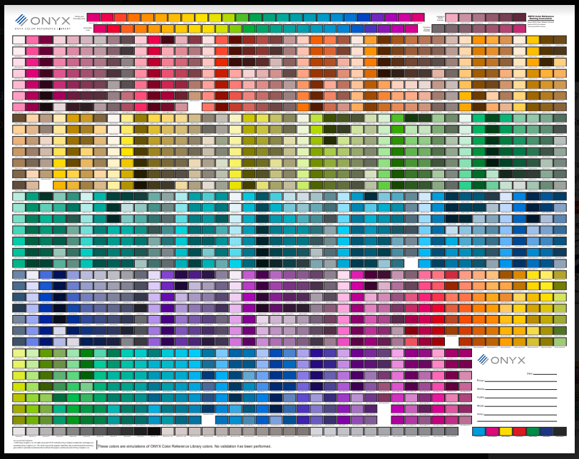

Onyx is trying to address this in ver 22 with the ONYX Color Reference Library. Since there is a plug-in in Illustrator, the design team can use the ONYX colors in the design process. I had an in-depth conversation with them about this, and it will be a mess when Adobe/Panton pulls the trigger. The workaround will be that companies that need a color match will need to provide a printed color reference or reference a Pantone color that you reference in a color deck, then use the Onyx Color Reference Library and the swatch function to dial in color, then save that swatch in the artwork. (simplified explanation, I know...)
