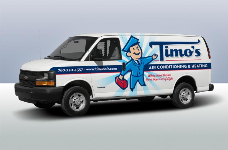

Here's a simple design for a HVAC company outside of San Diego. This is a Photoshop comp; the install will be done in a few weeks. We also did their branding.
I really enjoy comping these things up. And again, much respect for the guys who install them.

What's the planned setup for the partial? Print cut, or wrapping with white background up to front doors..or?

I would say print and cut the guy with gradient, and everything else print/cut vinyl. Can't really see wrapping this I don't think. But I suppose it depends on how fast you work on one method versus another perhaps.
If it rolled into your shop, what would you guys suggest?

If we were doing that, we'd probably make a complete piece of each side because of those blue rule fades. Other than that, if you can't use a real paint band... your idea of piecing it sounds about right. We would also probably hand cut the area over the front fender at the phone number to make it 100% accurate.

Probably full wrap as well.
Printing and cutting the guy would lead to two panels, so might as well avoid the lining up headaches with the rest of the vinyl

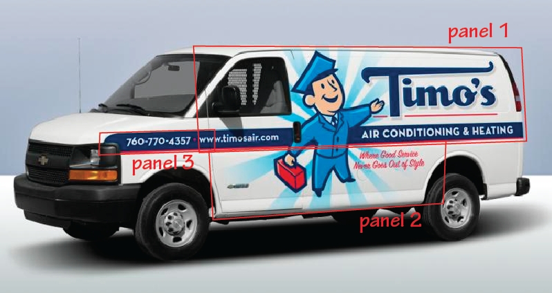

If the customer would accept it, we would prefer the full wrap method to avoid the plotter cutting and weeding processes resulting in quicker production times and higher profit margins. A reduction in decal preparation error and quicker installation times are also a benefit of wrapping. If the customer rejects the full wrap approach, then I would set up what is shown in three separate print/cut panels.
What does the other side of the vehicle look like? Is the character flipped horizontally or is the character and company name flipped or...?

That would realistically be an easier installation going the full wrap route. You'd save a little vinyl by nesting individual parts and doing it all as print/cut but not a ton, and the installation would be every bit as time consuming as just wrapping it... I'd do two horizontal panels and hide the seam in the red pinstripe.

The other side has character flipped, and pointing to the rear as well. I'm usually OK with flipping my icons/characters.
