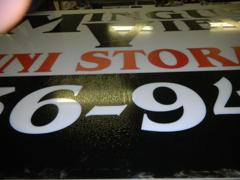

Using brand new sheets of poly. Do you just remove the protection sheet from the manufacturer and letter, or do you prep it somehow? I've been removing the sheet and lettering, but have had a few hits and misses such as bubbling of the vinyl. Usually takes a couple days for the bubbles to show. Interesting that it has always happened with the black vinyl and not the translucent colors.

just let it breathe a bit before lettering
Are you putting it down wet or dry ??
We always wipe it down with alcohol, whether it's translucent or digital media.
Zac
Mediocre Designer
Alcohol is great, another product I've used is alcohol based and has anti-static properties called Plastic Prep from Matthews Paint. It's pretty amazing. As long as the bubbles aren't too high pressure they should go away after a day or two.
I will generally lay vinyl wet on lexan/poly, even just a mist of rapid-tac/homeade works wonders.
300mphGraphics
Putting it down dry.
Vinyl is flat after application and panel installation on site, and takes a day or two to appear.

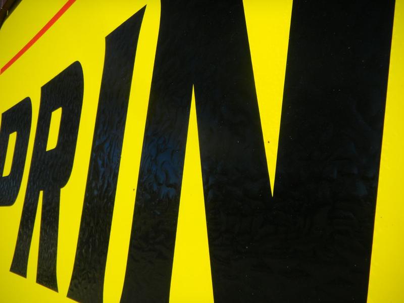

Here's another project, this one mine. This the yellow trans went down solid and the black Oracal 651 went right over the top. North side of the side is fine, south side has bubbled like crazy. Kind of cool effect, 3D signage! This one has been up for 2 months with no reduction in bubble size.

Another thread about polycarb & it will be another debate between two camps lol.
Still holding to my opinion - You have to let it sit after you peel of the plastic (i usually leave it overnight)
Never had this issue after i started to allow to "outgas" before lettering, or however you wanna call it :)
Outgassing ?? No, it's not, that. How does outgassing differentiate between yellow vs. black or that red rule at the top ??
J Hill Designs
outgassing argument aside, the black is opaque and the red/yellow are translucent, so there IS a differentiating factor :thumb:
Billct2
Dry app, differences are black being opaque, layered and it on;y happened on the south side. Maybe outgassing from the panel being heated by the sun is a possibility.
