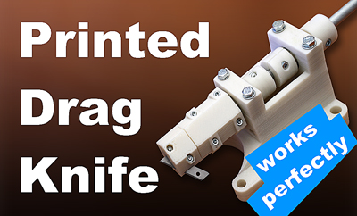

Hello folks,
I desided to make drag knife by using 3D printer with ABS material and common metal parts.
There is the result in video below.
[video=youtube;-MThK035omE]https://www.youtube.com/watch?v=-MThK035omE[/video]
or
http://youtu.be/-MThK035omE
You need any flat CNC. I built CNC by myself, it is combination common alluminum profiles, particle boards and printed ABS parts.
For running G-code I used Arduino with Sprinter. As the software for generation g-code I use Simply Cam 2,
you can import your data from vector programs like Corel, Illustrator...
Let it is an inspiration for you to make one.
Kamil

Yes I built also 3d printer, internet is full of instructions how to build it, it is easy, just difficult at beginning.
WB:
Working area is just a particle board with 1mm thick paper on, whole construction lays on wood table.
Typestries:
Yeah changing aspect is good, but what is great, that you are not limited with blade shape. you can choose your favorite blade and print the schell for it, like I did. That is cool.
I will try to upload stl files for close look.
