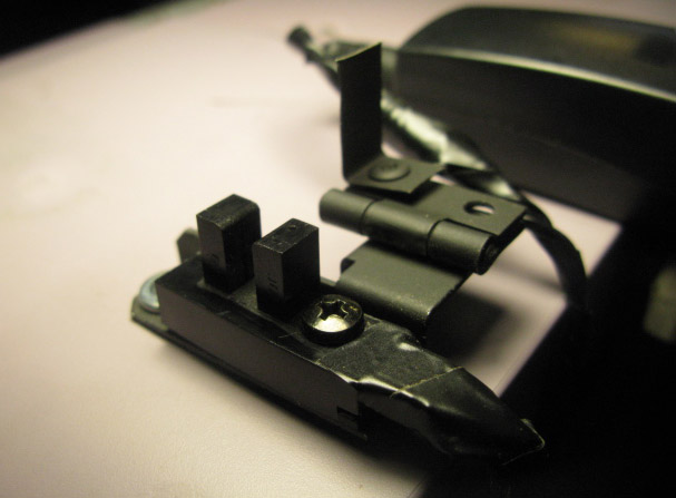

i'm a mimaki guy so forgive if this irrelevant. my printer firmware/auto measure (which on mine is rerouted outside the machine so i can force measure or not) has a margin that is attached after the auto measure. you can input an integer or negative margin into the panel and it will "add" a negative number thus not adding a positive margin and will print full bleed.
attached is the infra red reader taken out of the body of the machine and moved to the top so i can tell it when to or not to measure. very irritating when your machine does too much thinking for you.

What does your setup width come in at with tape on the edges of the 24" media?
As long as it reads 25" or more, you should be fine to get it to print edge to edge. If it's anything like the Rolands you can move the head to the start point and hit base point and it will start printing on that mark. You would only need the image in flexi set to 24.25 to ensure printing over the edge. You will get a build up ink on the edges that may pool enought to drag onto the print.
