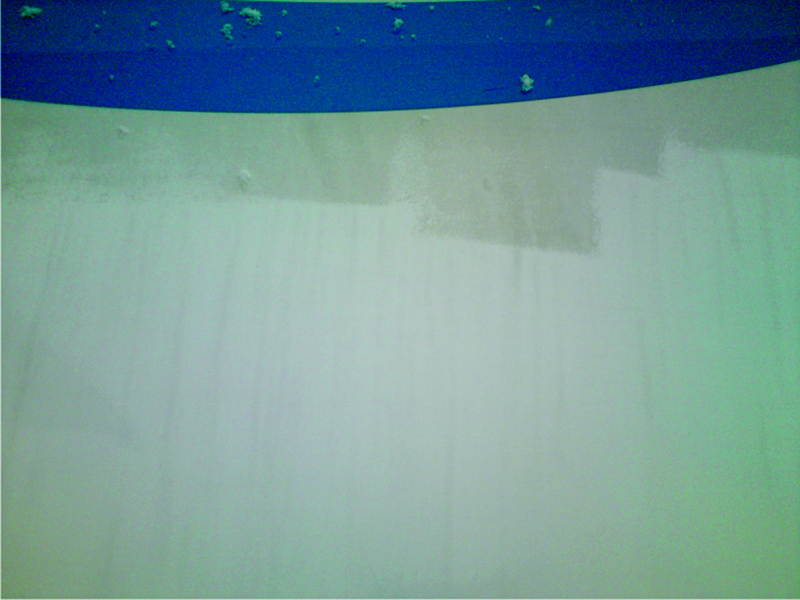

Look like this vehicle ...
Oh-h-h-h..... you're rolling this on after they're on the vehicles.
What you have there is called 'burning'. Just about every liquid clear burns anything it goes over top. If you're careful, you won't see this. However, it still takes place. Because the clears have a tendency to just make things usually a yellowish brown translucent appearance, it's called burning. When going over-top of many colors, it's not noticeable, but when you hit complete white or solid areas, you will quickly see the paint start to burn. It's kinda like getting a sunburn. It's hastens the pace.

Alright, we're getting closer..............
Now, I don’t know about you’re procedure, but it doesn’t really look like that’s what was followed here.
You can clearly see there are streaks of dirt on the truck below the clear and under the clear, but not on top of the print, which indicates, the truck wasn’t even washed properly or prepped before putting anything down. This looks like you stuck the print onto the truck, then cleared with a roller and made lousy pulls and didn’t even bother to feather out your roller marks. The unevenness of your rolling technique speaks volumes.
If you don’t know any better…. that’s one thing, but to try and pass this off as industry standard…. nope, cannot do.
Also, what are all of those flakey things on the dark blue ??
Last thing…. where the streaks and roller marks appear in your sample…. is that on the truck body or is it covered with vinyl from top to bottom on all the trucks you have pictured….. both sides ??

This flakey on the blue surface of the snow, winter is here.
The truck was covered with vinyl from top to bottom .. this gray line is the lamination.
In this section clearly shows the difference lamination ...
So, what is this ?? You didn't laminate the entire area, just where there was ink and were kinda sloppy about it.
If you went the entire way, up and down, you wouldn't see it.

now i see it.
There is snow on the print. But those marks I thought were pressure washer marks are actually the liquid lam.
That is a totally different deal.
Yes you made a mistake. You must lam the entire sheet. Liquid or plastic no matter. The whole piece must be coated.
As for using liquid lam yes, It is done that way all the time. Flat surfaces and short term is Ok. But the entire piece must be coated.

No, you still are missing the point. Liquid lam will burn anything it goes on. It burned where you got a little sloppy and it's become quite evident you have done this wrong. Had you liquid laminated the entire print, you would not see this at all... at least not near as much.
As Tech has mentioned, some people still use liquid lam, but you must be consistent and do everything.... not just here and there.
So.... let's do this again.......
  • Liquid laminate will grey or burn vinyl, ink and just about anything else you put it on.
  • If you partially liquid laminate, only the parts which have clear on will show up as grey or burned.
