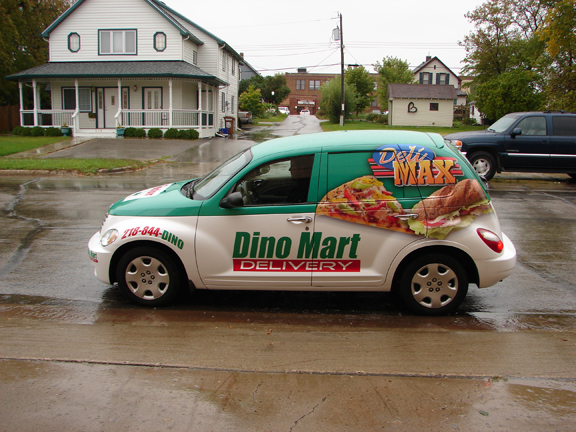

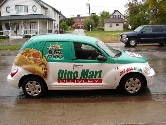

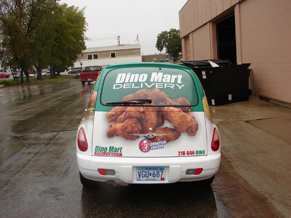

Here is a cruiser we just got out of our shop. it is for a new gas station that offers deli max, texos tacos, and broasted chicken.

Looks like that line right in the body groove would've been fun to install!
We actually printed the bottom white with a 3 inch bleed and then the top green with a 3 inch bleed and they over lap in the body line. would have been close to impossible to get the line to the right arc to follow body line with out getting a head ache and alot of stretching. we might have used for material but made for an easier install.

Question....... is that perf over the windows or regular vinyl ?? I can hardly tell, if at all, the discoloration from perf products.

The side windows are solid material, only the back is perf. we still haven't found a good perf material.

oh, nice wrap job too. i'm not real keen on text following the curve of the wheel well, but other than that... it looks great!

perfect in every way! I'm extremely impressed you got the phone number to follow the wheelwell arch so well, with the amount of stretching involved in those fenders it's amazing how well that fits and flows. Very good job!

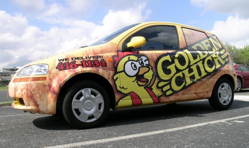

Reminds me of the Fried Chicken car I did several years ago... They really didn't know what they wanted, so I just covered the car in chicken. Yummy.
