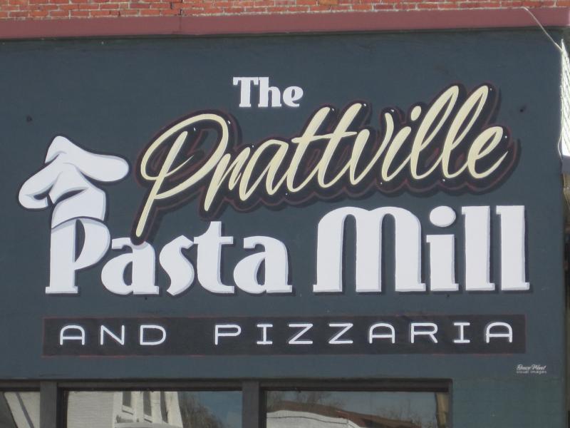

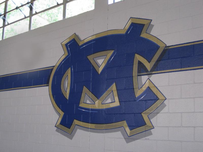

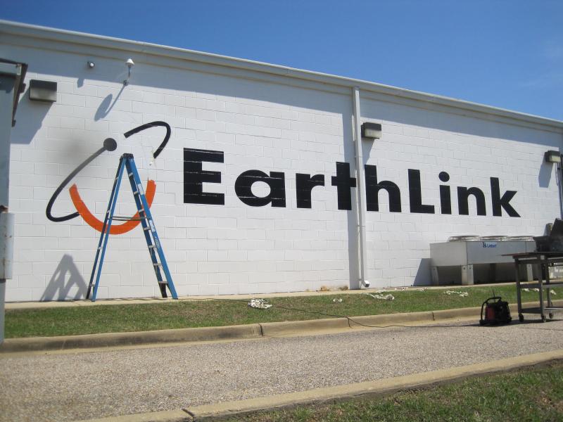

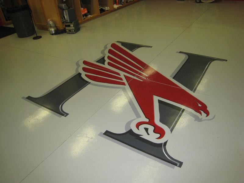

All our wall paintings are done with latex paints. one shot sucks. we use benjamin moore ext satin latex on some and for high gloss we have used rust skat paints.

Jillbeans
Nice work, Bruce.
I just completed a mural using the exterior latex sold by True Value, it was nice to work with but did require double coating.
I have never thought that clear-coating was a good idea.
visual800
Nice work, Bruce.
yeah i saw that mural you just did, i like it!
