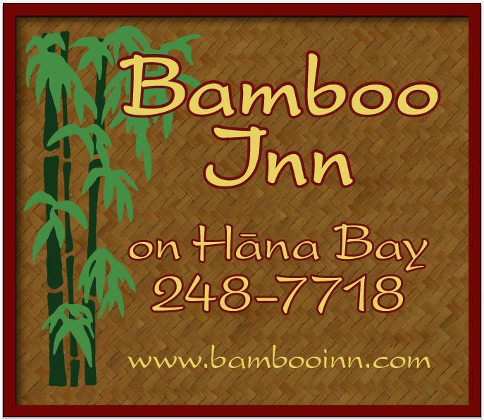

The first attachment will be the proof of my final product. I wanted to do most of this sign as a single 3D routed HDU sign, and even got as far as programing (& test running a small sample of) the woven mat background, which is an actual Bamboo product...

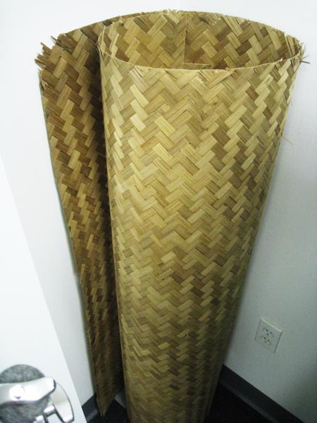

...but my client really wants to go with using the bamboo mat itself (second attachment) & he has been informed, and accepted that I can not warranty the life expectancy of the sign as a result. That sort of texture is of common interest around here, so I don't mind the time spent on creating a routing file for it, or the chance to experiment with using the actual product on a sign where the end user has taken on some of the risk for experimentation...

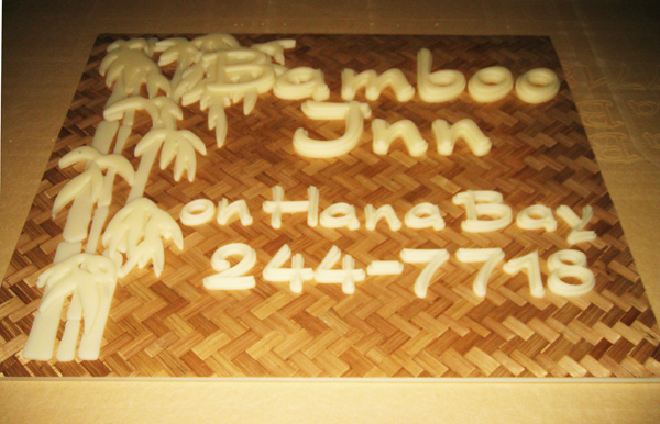

But anyway, now that you have some of the initial background information, the plan at this stage is to use an adhesive & bond the mat to 1/4" acrylic. This will then get a sealer/stain. I will assemble a wood frame, routed like a picture frame from the back to protect & hide the edges of the mat.
Here is where I have some acrylic questions. I plan to bond a lot of acrylic to the stained mat & for this I plan to use liquid nails. If anyone has suggestions, or cautionary information related to this, I'm interested, but i don't have too many concerns with that step...
The steps I'm unsure of is the painting of the acrylic, and the bonding on multiple layers of acrylic. I know the acrylic cement needs to melt raw acrylic, but I also know pre-painting items before bonding means I can spray them, so now i have questions about bonding them, spraying thenm, and rolling paint on the faces.
I think the best plan I can come up with so far (without starting over) is to cement everything together & spray all the bamboo stuff dark green, & then roll on 2 coats of the light green just on the face of the top layer... and for the lettering, bond with acrylic cement, spray the burgundy, & roll on two coats of the imitation gold color.
Now, I am definitely open to feedback on those ideas. The most obvious alternative to me is to forget the acrylic cement, spray all my colors, & then bond with some other adhesive that doesn't mind bonding painted surfaces... which brings me to my paint questions...
I am not a paint expert by any means.. I've rolled 1-shot on panels for many years, & I've also painted small wood or PVC letters with a foam brush... my only spraying experiences are a lifetime of playing with rattle-can spray paints, and a little bit of experience spraying Porter latex with an HVLP gun on HDU...
so, on the all important paint questions, what surface prep might I need for acrylic? Just clean & free of dust, or do i need to scuff it with a 600 grit or steel wool? What paints can people give me feedback on... enamel spray paint? Latex enamel thinned for HVLP? Rolling on 1-shot?
..and of course if I do go with spraying the different colored parts separately, what adhesive can be recommended for bonding the unpainted acrylic backs of letters to the painted acrylic faces of their outlines pieces?

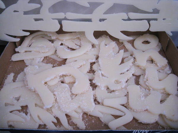

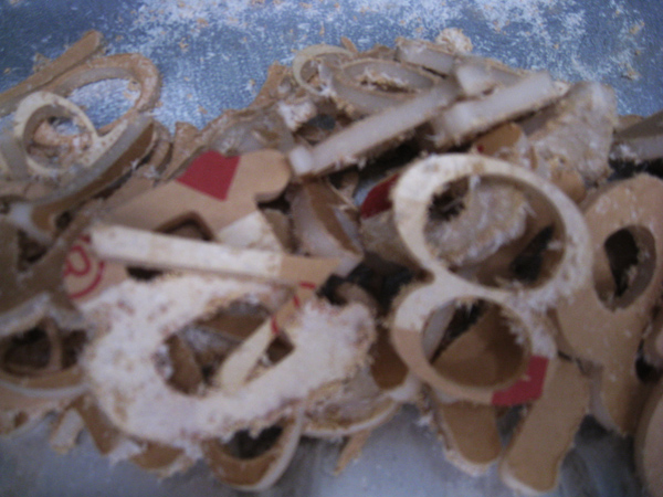

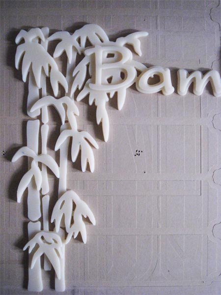

the last round of questions pertains to some of the other unforeseen challenges in the largest batch of acrylic lettering I've ever cut... I used a carpet tape for holding down the acrylic. Some I peeled the paper liner before routing, some not... but in either case, the "sawdust" sticks to the edges where there was tape, because the process of cutting seems to get adhesive on the edges, or mixed in with the sawdust & it doesn't blow off with the compressor like I hoped... so it becomes a bit of a chore to wipe off... anyway, I pretty much have everything cleaned up, but if I wanted to get them even cleaner, I wondered about soaking the letters in something that breaks down that adhesive residue but doesn't hurt the acrylic...
..as for that last question, if the right answer would have been to paint first, mask, then rout, or perhaps to stock some kind of sheet version of 3M VHB tape & have that applied to acrylic before routing... well, go ahead and advise me of any tips and tricks any of you have to offer, even if it means I'm already doing it wrong... it's never too late to learn, and I'm the first to admit I have a lot to learn on my relatively new foray into the world of CNC and to a slightly lesser degree, the world of paint.
The last few attached pics show the acrylic pieces in there slightly sticky sawdust covered state, before peeling paper, or carpet tape... and then the semi complete layout of unpainted pieces (minus the uncut web address) ...and following a quick edit, I've added a photo of the clients old sandblasted sign, which I've never seen in person but copied from this pic...

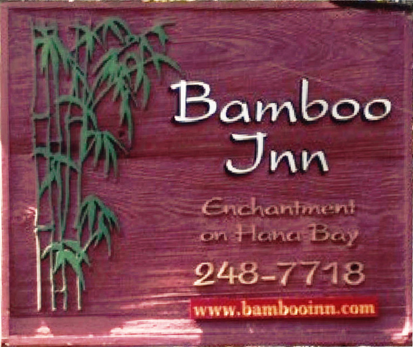

Hmm....this is a little complicated but my first thought is that you're just going to have to try out some of those methods on some scrap and use the one you are most comfortable with. You know there's no real wrong or right way, just the way that you can accomplish the task in the most efficient manner. By the way, is this for interior or exterior use?
Now, if I understand correctly, you have double layer lettering that you're unsure of bonding/painting, painting/bonding. I think I would agree with you and my first attempt, now that all the letters are already cut, would be to use WeldOn #16 to bond all the letters, spray them all with Krylon Fusion Burgandy, then top coat the letters with the Gold in a paint of your choice. The same treatment with the green elements.
You possibly could have done some coloring before routing by either flood coating with vinyl or painting and masking, but then what about the edges? You could also pre-apply a wide double sided adhesive but that is something you'd have to have available and the wide widths are expensive.
If you have to do any other bonding with painted or unpainted pieces, as much as I hate going near the stuff, silicone works very well.
As far as using carpet tape, I think that is a big error, especially if it is the run of the mill type in a carpet store or Home Depot. That stuff is a hazard, you need a good tape like InterTape 591 and then you won't have those issues. If you need a chemical helper to clean the adhesive residue, the only thing I'd try on that acrylic is Rapid Adhesive Remover.

I would WeldOn #16 your acrylics together. I’d try to keep the paint off the sections to be glued. If you aren’t going to guarantee the sign, you might be able to get away with some Krylon for plastic use rattle cans. I’ve used it for quite a few applications and most of that being red and it’s held up for almost 4 years now.
I’m not a fan of liquid nails because when it dries it becomes super hard and that’s Okay for wood [which its intended use is] but for plastic, you might want to think about using small pins by drilling out the back of the finished letter, gluing in a nail [with the head clipped off] and then setting it into the wood backer behind the bamboo mat.
What you’re doing is what we used to do when we sandblasted signs with varying layers. However, we always handpainted in all of those areas… which is time consuming, but very nice when finished. I’m afraid Doug, that there isn’t a quick fix to getting your layered colors down without cutting some corners which might cut the integrity of your craftsmanship.

if you are experimenting with some adhesives. the weld-on is good. but will create a brittle matrix. liquid nails is flat out a no. for that, use loctite universal T.A.C. (available at lowe's!) it is by far the most impressive one part adhesive i've every come across. it's very high viscosity. if you are going to use it a lot, i'd get a cheap electric caulking gun from HF.
as for the painting, i'd hit with a plastic primer before hand (about three quick coats). it will gap fill, giving it a more monolithic look, and have a softer sandable surface that will let your pigment go down much more attractively.

If I understand correctly,the carpet tape is what you use to hold the letters while routing and it leaves residue? You can clean that with mineral spirits or alcohol. For the painting/bonding of the acrylic letters you could use "spray" mask or transfer tape on those areas where the letters will be bonded, that will give you direct acrylic to acrylic bonding which is the most durable.

for painting acrylic there is only one product i really like Lacryll (spl?) i know pacific coast paint sells it and they will even custom mix colors for you and put it into spray cans (or at least they used to).
for painting cut letters here is what i like to do. take a sheet of HIGH TAC transfer tape with the adhesive facing up and stick the bottoms of the letters to the tape. then i spray the letters the color of the returns (unless i am using a substrate that the color is the same as the return). then when dry i paint the faces. for me it takes much more time to paint the returns than the faces so i would rather get that part of the job out of the way with the spray process.
obviously you can also spray the sheet before you cut it so the faces are painted then mask and then cut, leaving the premask on the faces and then spray the returns...in my experience it is more work than it is worth...cleaning runs that get under the face etc.
acrylic in my experience always leaves a little debris that needs to be cleaned up. but yours look excessive. i would say it is a result of hte carpet tape. i only use carpet tape when in a pinch and nothing else is available. i would much rather use a double sided masking tape..it is also possible with your router to cut right through the substrate and not through the tape..it truly is possible.
but for acrylic letters what i have always done is blow the pieces off with compressed air as i pull them off the table this usually gets most of the debris but then i throw them into a bucket of water and when they are all in there i wipe them off one by one the reason i do this is i am preparing for paint and dont want any 'stuff' on them at all.
just be happy you are not having to polish the edges on your cut letters for picky clients.

The first thing I would do is take the bamboo matting into the booth and give it at least two heavy coats of UV stabilised two pack lacquer. The first coat should be almost fully absorbed by the wood fibres, the second coat should do the final top seal. This method will fully waterproof the bamboo and prevent aging from sunlight; in theory the mat should last years.
For bonding the painted acrylics together the easiest and cleanest method would be to use a clear 3M VHB tape, one rated for sign applications. This will stick like $hit to an acrylic blanket. If you have lacquered the bamboo to a good finish then there is no reason why pads of VHB won't be suitable for fixing the acrylic letters in place; there isn't an awful lot of weight involved and this VHB method is quick and doesn't involve splodges of liquid adhesive going everywhere.
For the painting process you could nip down to your local auto paint factors; there is a clear plastic primer/ binder product available which works on just about any kind of plastic. A coat of this will fully bind to the acrylic leaving a paint receptive surface for the following colour coats.
Personally I would avoid rattle cans if at all possible, even the cheapest gravity fed spray gun will give you an better finish and make painting much easier, even better, get a small touch up gun, these are perfect for paint small, complicated items like lettering. If you go down the spray gun route you can use many more kinds of paint and the savings buying paint in liquid cans rather than aerosol tins is considerable.

after rereading ... definitely clear coat that bamboo. just a few coats of precat lacquer or cab lacquer in a medium hand rubbed. it will be difficult to buff out with all the texture so i'd go semi, and sand with 600 only.

lots of great replies.. I'm working today & can't write for very long but the bamboo has been used for over 4 years on all the walls on this clients vacation rental property. He coated it with a particular product that he offered to provide to me during the "no warranty" discussion... but then he brought it in an unlabeled glass jar, so I need to get specs from him on that product.
