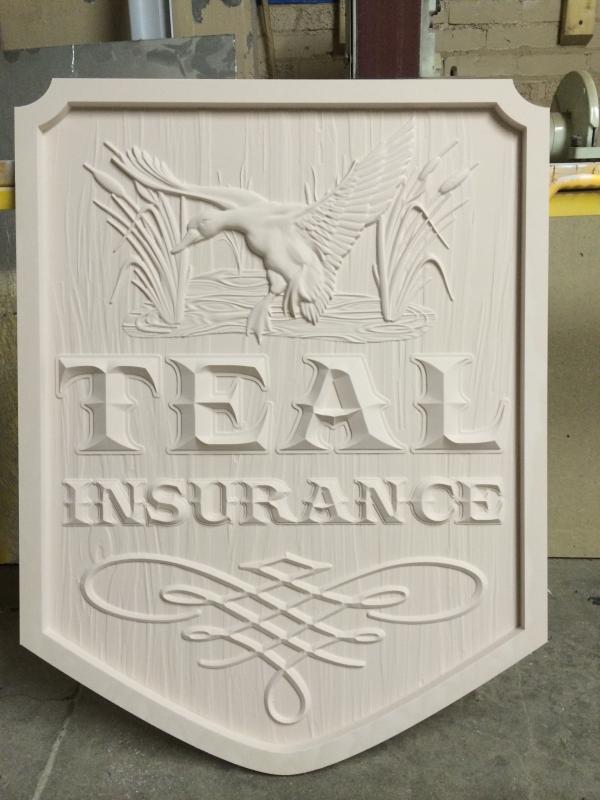

we just finished carving half of this sign today. It will hang from a tree with 1 limb and be mounted to a steel sleeve we anchor in the ground.

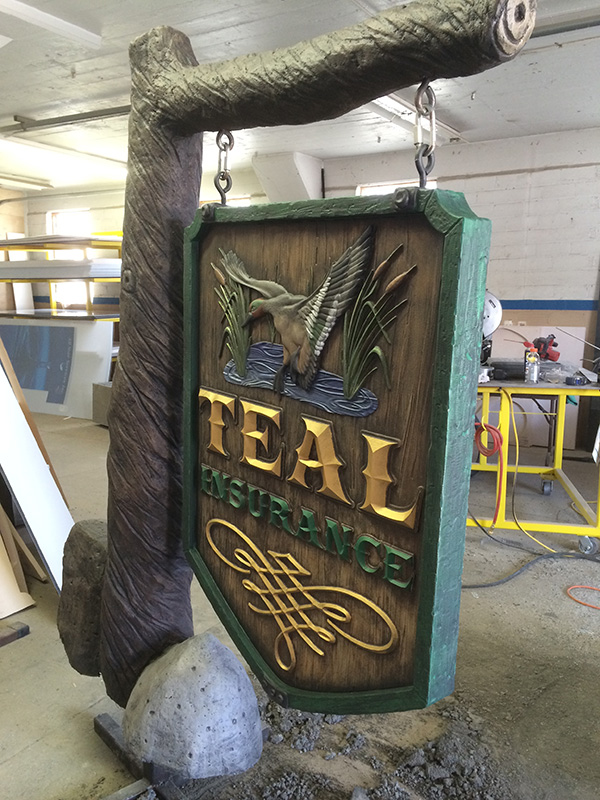

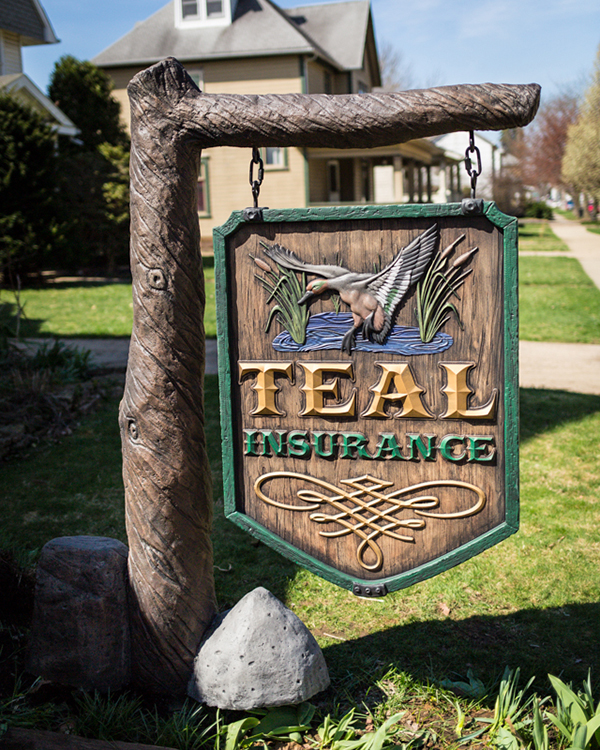

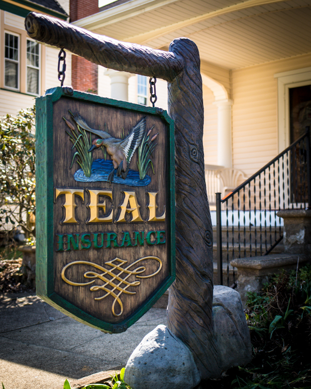

Here is the teal sign. Painted, glazed, ready for finishing touches and clear coat.

Jim fantastic finishes and a nice, nice design!
Thanks! this was a fun one. The finishes turned out better than I even imagined.
Zx - we use epoxy clay / putty to fill in any dings and then sand flat after it cures. I have used the stuff from Reynolds, Apoxie, and Magic Scuplt. They wall work about the same.

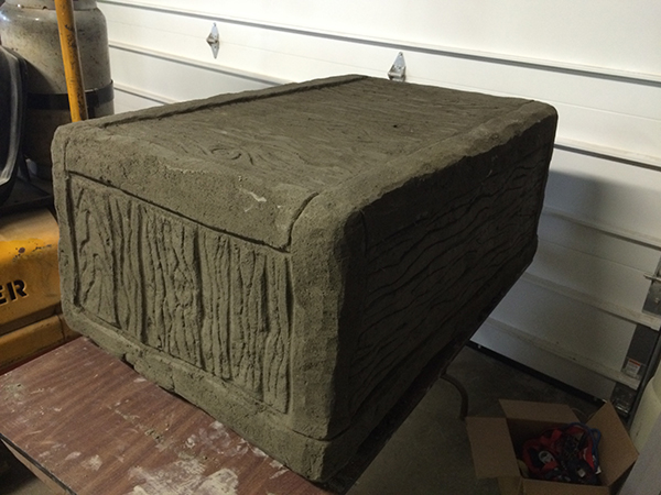

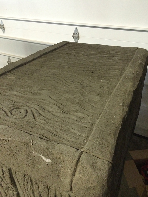

building a base for the gear set... sculpted concrete over a wood frame.

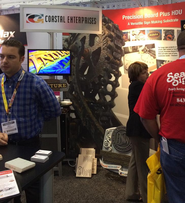

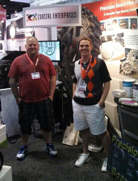

Pics of our gearbox feature in the booth along with Brad and Kellie from Coastal Enterprises.

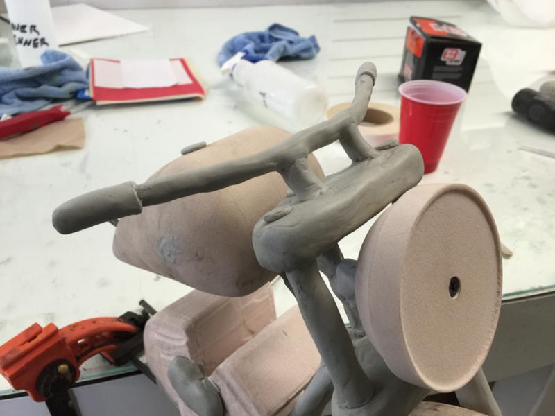

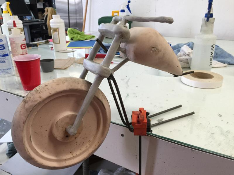

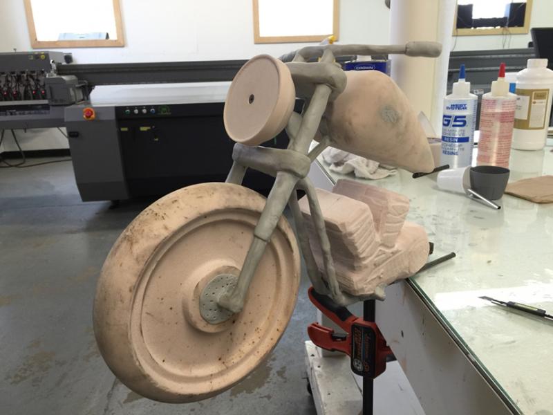

here is our latest fabricated unit. Its 74" tall x 84" wide. Steel, Plexi, 30lb Precision Board, and some ACM for trim panels. I have a sculpted motorcycle and dodge charger that go in the centers of the small gears. Updated pics will be posted when we finish.

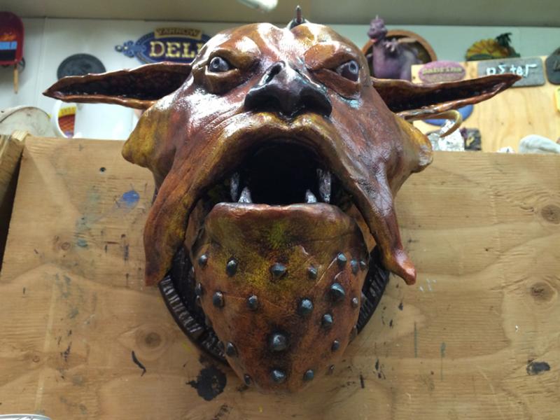

a few more items
just returned home from Dan Sawatzky's sculpture magic workshop. Back at it again!!!
Aslo we ordered our Multicam 3000 series router on Friday. Anyone looking for a 5x10 with 8 tool changer and vision PM me....
