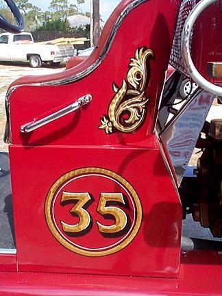

As for the debate of signgold vs real gilding,..I have lettered and gilded over 100 fire apparatus vehicles over the span of my career and never once did I try to use signgold,..all you have to see is a true good gilding job get close enough to a fire to melt the plastic reflector lenses one time to realize signgold just don't cut the mustard,..real gold will hold up as long as the paint it is on,if done properly,..thats the problem nowadays 99 out of 100 ppl trying to convince the client they know what they are doing actually don't.And the part about the clear coats not holding up are a farce also,..,the clear coats available today are ten times better than anything that has been available in the past,..you just have to know what you are doing,....and do it well.
