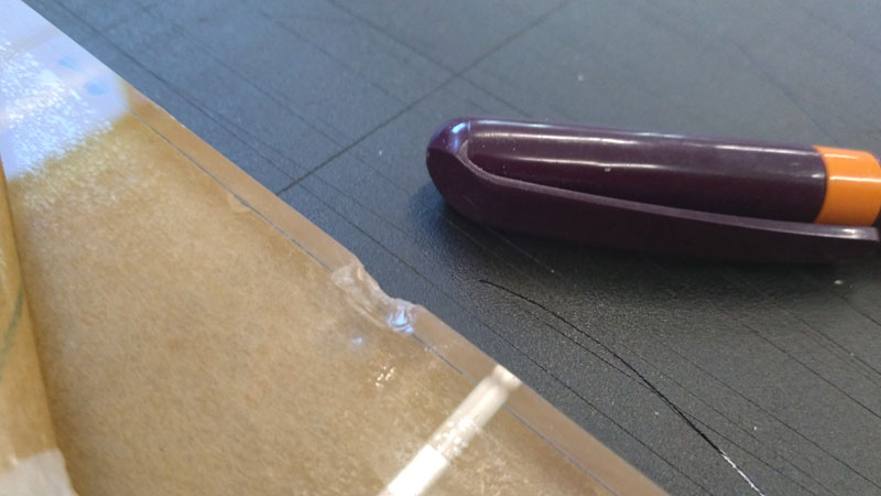

I ended up with a chip along the edge of some 3/8" acrylic, either from running the saw or getting bumped by something. Either way, can I somehow patch or fill in this chip as mentioned above, or is it a waste of time? The acrylic is going to be painted so any defects will be covered up. I'm just worried that the patch won't stick, or might develop into a crack if the sheet flexes at all. I might just try buzz trimming a 1/4" off that edge instead. How would you handle it?

I used a track saw with whatever blade came with it. Usually it does a good job cutting acrylic, but it's possible I pushed it too fast.
By buzz trim I just meant cutting enough off that edge to clear the chip. Might be easier than fussing with trying to patch it.

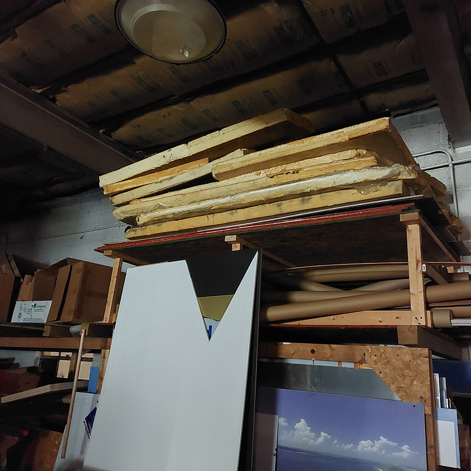

In my experience, the pink foam is too dense to use with a jigsaw, on top of being limited to 1" or so. But not a lot of folks know the joy of tracing and hand cutting letters, let alone where to find 4" thick sheets.
Our old shop from more than 22 years ago, was originally a vehicle body shop. A new owner bought it and started doing liners for refrigeration trailers. He got sued and hadda move out in a hurry before the cops caught up to him. He left so many forms and whatnot there, so we scarfed a few of them up and brought them along to this shop. I still have a bunch of them. 2'' up to 5" with the majority of them around 4".
